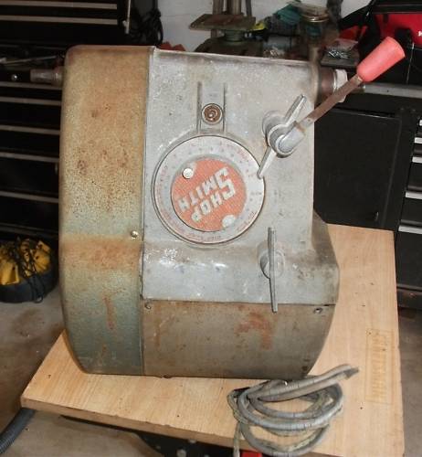

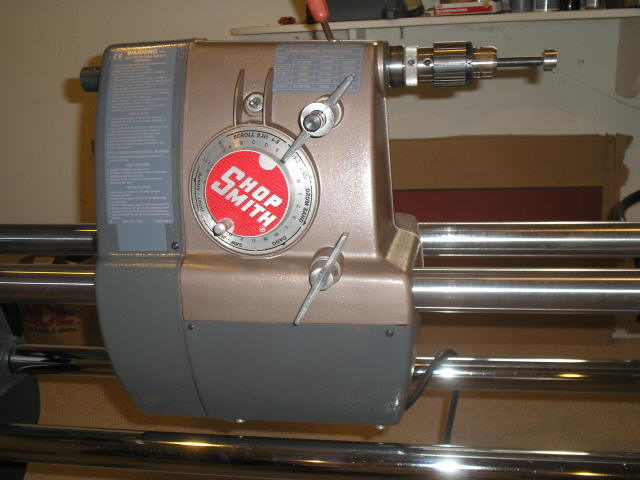

Hi,
I've been swapping things around while I wait for the Power Pro retrofit to come in for my main machine. I obtained a $1.00 (plus Shipping) 1959 headstock. I was able to revive the 3/4-hp motor, and then cleaned and reworked everything. This is my dedicated Shorty motor now.

The headstock is beautiful. What colors did you use? Looks like you either got some new parts (speed control and speed indicator dial) or you have really done a wonderful job of cleaning up and repainting. The bench tubes look like a slightly more recent vintage than the headstock.nuhobby wrote:Hi,

Thanks! The motor-pan and belt-cover are in the 'newer' Shopsmith gray paint, which came out glossier than the typical OEM Shopsmith parts. The aluminum casting is in a "hammered" paint I got at Ace Hardware, by Krylon I think, not one of the more popular Hammered series. In fact it seemed to paint like gloss-paint, with hardly any hammering/dimpling obvious. I used the speed-indicator ring and internal Poly-V parts from my late-model machine, but was able to redo the original '59 speed-knob with cleaning and red enamel paint. Inside, the rusty GE 3/4-hp motor appeared never to have had any paint, so I left it wire-brushed and waxed. Past postings by mickyd, etc., were very helpful on servicing that motor.SDSSmith wrote:The headstock is beautiful. What colors did you use? Looks like you either got some new parts (speed control and speed indicator dial) or you have really done a wonderful job of cleaning up and repainting. The bench tubes look like a slightly more recent vintage than the headstock.I guess you won't be trading this headstock in for your Power Pro.

Did you order new warning and speed chart stickers from Shopsmith or did you make them?

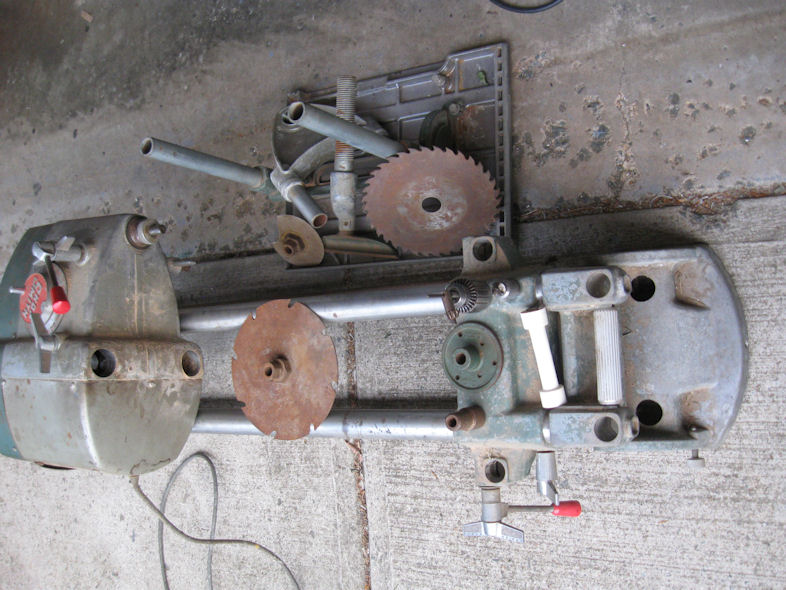

I just got that old $50 greenie Shopsmith Mark 5 back in service and working ok. My goal was to get it back in service so it is refurbished ( mostly cosmetic) but not like "new".
Info from this site was invaluable. I replaced the speed control dial because its gear was partially stripped and the carriage that I stupidly broke a piece out of when loading into my truck ( failed to lock headstock) by getting replacements off Ebay. The porkchop was swapped in from a spare head I have and oil holes were added to the pulleys. No bearings were replaced (yet), fingers crossed!

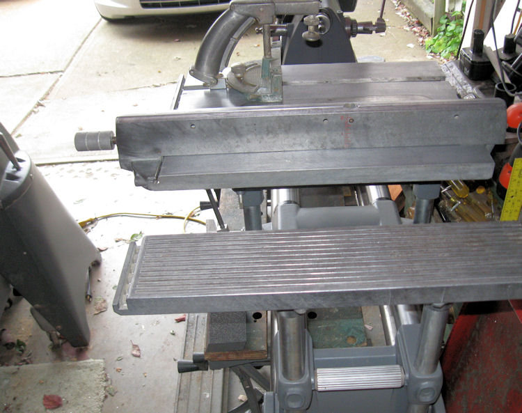

[ATTACH]10626[/ATTACH]
I took the head all apart and cleaned out the compacted sawdust and stripped to bare metal, primed and painted the parts to match my other machine, a 510.

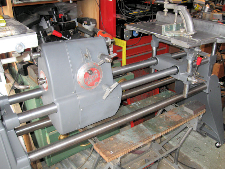

[ATTACH]10627[/ATTACH]

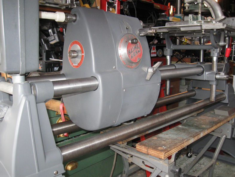

I used Rustoleum textured spray paint in dark pewter colour, 2 coats, a really good colour match ( but it is a more or less a flat finish, not semi-gloss). I made a slow speed aux. drive for my other SS and sanded rust off the steel tubes and waxed them; they look ok and work fine...the head slides nicely. I freed up the quill so it strokes ok. I replaced the power cord and added 4 casters.
[ATTACH]10628[/ATTACH]
I still have to refurbish the miter gauge. I intend to leave my band saw and sanding disk set up on it more or less permanently, and use the 510 for table sawing, strip sanding,jig sawing, etc.
