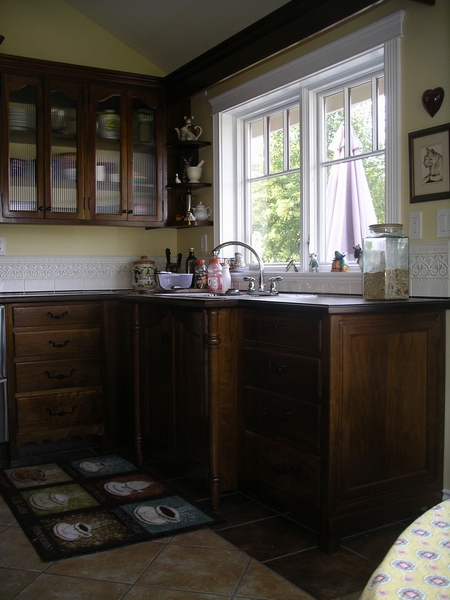

When I built our kitchen cabinets I made all the door frames, finished them, mounted them and then took them down and took the whole pile - about a dozen - to the glass shop. When I picked them up the next day they had glass in them and I remounted them. Interestingly they didn't measure at all. They laid the frame on the glass and traced from the piece then cut the trace line. They are +/- 1/16 small all the way around and they don't rattle because the glass shop installed them with clear silicon adhesive. They said I could add some retainers if I wanted but I'd be wasting my time. I didn't bother and five years later they're still there.
[ATTACH]8805[/ATTACH]
Not a great picture of the glass doors but its the only one I had handy.
Paul M
