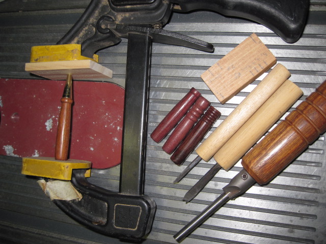

Here's a picture of an alternative for pressing pen parts together using a quick grip clamp. A block of softwood can be used when inserting the tip of the pen so as not to damage the rubber face of the clamp. You could also use the wood vise on a workbench, especially when pressing the transmission into the body of the pen because you want positive control over how deep it gets pressed into the body and the softer rubber in the clamp may not provide the proper "feel" for the operation.
The picture also shows the barrel trimming/squaring tool I've used with a handle attached, although doing it under power mounted in the headstock would be much easier and quicker especially if you cut your blanks a bit too long.
There are also a couple of turning tools made from cut nails and shaped with the sanding disk and dremel tool.
And, there are a couple of turned pen parts that never made it into pens, together with a "story" block for laying out the beads on the pens.

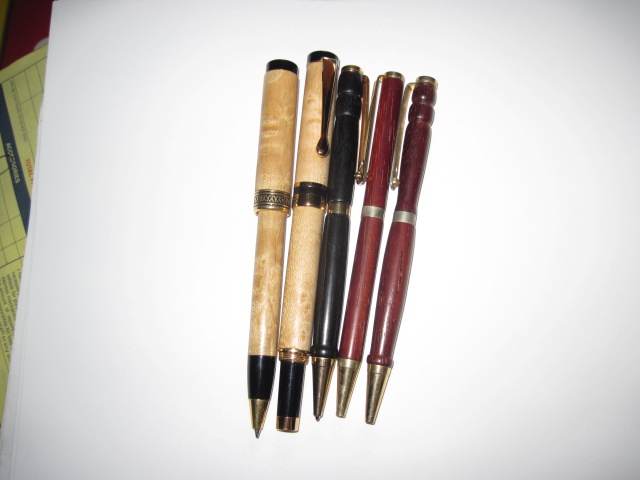

The second photograph shows some pens that didn't make the grade for one reason or another. I keep them around to remind me of some things that shouldn't be done.
- the ink cartridge doesn't retract into the pen of curly maple on the left.
- the second one from the left, the fountain pen of birdseye maple is an example of not squaring the blank to the tube. It's probably not noticeable but the end piece is cocked a bit.
- the middle pen is of ebony that cracked after assembly -- guess the wood wasn't dry enough -- something to consider when buying some of those exotics with waxed ends.
-the next pen of padauk is something Mark warned about -- assembling the pen before the CA has fully dried and then not being able to separate the two halves to install a new ink cartridge.
- the last pen is also of padauk and here I just didn't like the looks of the upper part, but I still use it.
