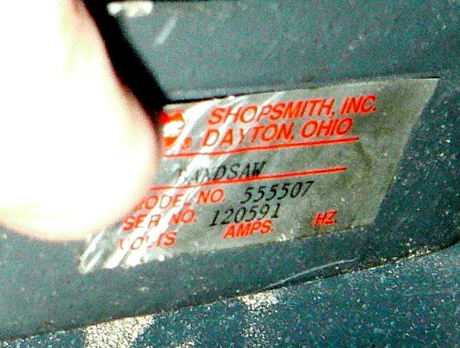

reible wrote:FYI, I rechecked my serial number against the chart and it indicates mine is from 1985 and did not have the nylon bolt. Of course when you get something used who knows what has been done to it....
http://www.shopsmith.com/ownersite/faq/bandsaw.htm
WOW I had no idea, according to my serial number I got mine 10/28/1996 long after I though. I guess when you get old your memory goes not that I ever had a good one.

[ATTACH]13806[/ATTACH]
All pix of a '91' vintage.

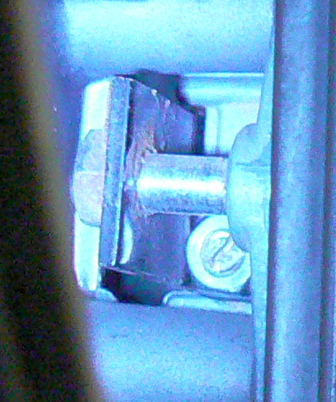

[ATTACH]13807[/ATTACH]
Der Ahctung Label.

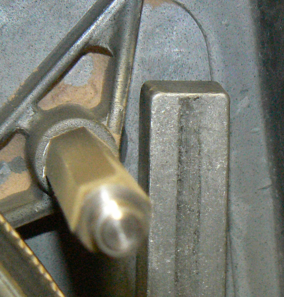

[ATTACH]13808[/ATTACH]
Post anti slop screw(brass with steel jam nut)

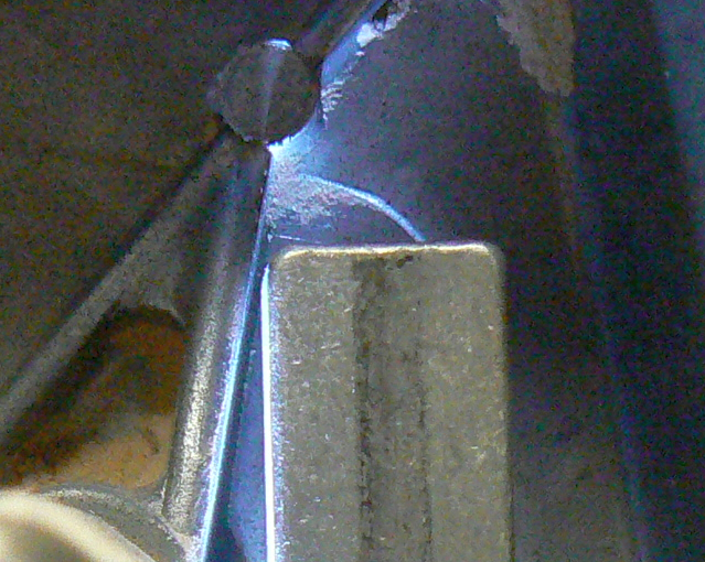

[ATTACH]13809[/ATTACH]
Post clearance at top of motion.
[ATTACH]13810[/ATTACH]
Maximum height limited by bearing interference with 'nut'.

dusty wrote:There have been some mechanical changes made. I have a full 1/2" clearance between the bearing and that nut (depicted in your last picture).
Upward motion on mine is limited by the shaft interferring with a rib in the housing.
Looking at both Ed's pix and mine, I notice Ed's hits the rib at a height of the post higher than in my pix. I admit the upper backup bearing has been changed(dual narrower bearings), but they have the same od as the original.
Dusty, if yours hits the rib with a half inch clearance bearing to nut, where on the rib is the post hitting????
IMHO these differences can be explained by differing positioning of the post mounting parts. Lotsa adjustments that cause parts positioning to vary.
I side with Ed in that I do not think hitting the rib is a good way to limit travel. The bearing to nut interference is not ideal either, but better.
After looking at my bandsaw, I 'discovered' the following:
1) I can only get 5 5/8" cut depth.
2) I apparently put the backup bearing in the upper of two positions. I now believe it should be 1" lower. (Perusing the manual verifies that)
3) If the bearing were lower, the post travel would be limited by the wider part of the post casting hitting the guide casting about 1/2" higher than it is now. That would result in a 1/2" bearing/nut clearance like Dusty's. It would also result in 6 1/8" cut depth. The top of the post would be closer to the rib, but I do not think it will hit.
It shall be changed!!!!! Will repost pix after changing!

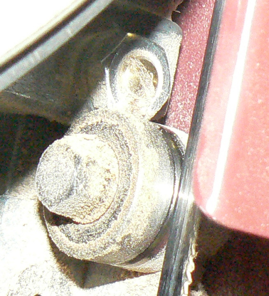

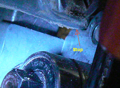

After 'changing' the following has occurred.
1) Cut depth is now a smidgen over 6"!
2) Post to rib clearance is quite small(1/32").
3) The upper travel is now limited by post and guide castings.
[ATTACH]13813[/ATTACH] [ATTACH]13814[/ATTACH]
Thanks for asking the ???, pointing out discrepency and causing me to re-examine(fix) mine!!!:D

- bs upper stop after.jpg (316.53 KiB) Viewed 9114 times
