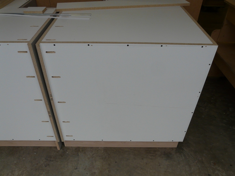

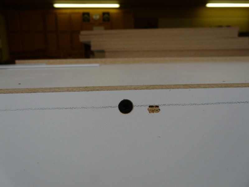

- Posts: 1627
- Location: Greer SC
wannabewoodworker wrote:
I have been re-reading the post again as it is fascinating watching the thing come together. Though being a completely inexperienced noob I have a few questions. On the carcass with the bifold? doors I see pocket holes on two sides of the frame but nowhere else how do you fasten the rest of that frame together? There are no dadoes used in this particular construction technique? If so what is providing the strength to the frame? On the drawers that slide out I think I see mitered corners? If so how is that drawer constructed? Could you have also screwed through the OSB into the the opposite surface to fasten knowing that you would be covering it up with Formica or that isn't possible because you cover first due to the ease of covering before constructing? Sorry for all the questions MB I hope you don't mind answering rookie questions but I really am quite fascinated and yearn for more knowledge thanks again for your generous sharing of your expertise.
In the old days I would have tacked nailed and screwed the cabinets together and then laminated the finished ends. There is always the chance of either blowing out the melamine. Then along comes Festool with a new idea.
All of these cabinets are joined with a combination of Festool domino's and pocket screws. The two work great together and solve each others shortcomings. I cover all the finished ends before assembly. The drawers are built the same way and the fronts of the pullout drawers are laminated to cover the pocket screws and raw edges. I believe the area that you do not see pocket screws is on the actual backs of the corner cabinets. Those are screwed through the face of the melamine and also have some pocket screws. I will post a picture of that later.
Mark
2017 Power Pro Mark 7
Mark
- Posts: 1627
[ATTACH]15685[/ATTACH]
Back of corner cabinets.
[ATTACH]15686[/ATTACH]
Old style of tack nailing, predrilling and screwing through the face of the melamine.
