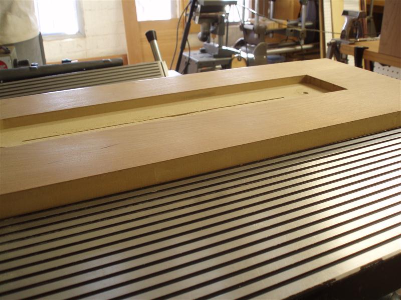

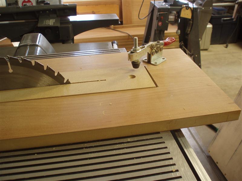

Still ANOTHER learning experience. This sled may never get finished but I'll not quit trying.
It is just a good thing that I don't really need it.
This time I failed to clamp everything securely and the project moved under the pattern. I usually use a couple pieces of two sided tape ot a couple brad nails to prevent this from happening. Not this time. I get to try still again.
It is also a good thing that I am using scraps and cutoffs. If I was cutting up good wood it would have already become cost prohibitive.:rolleyes:
ZCI Sled

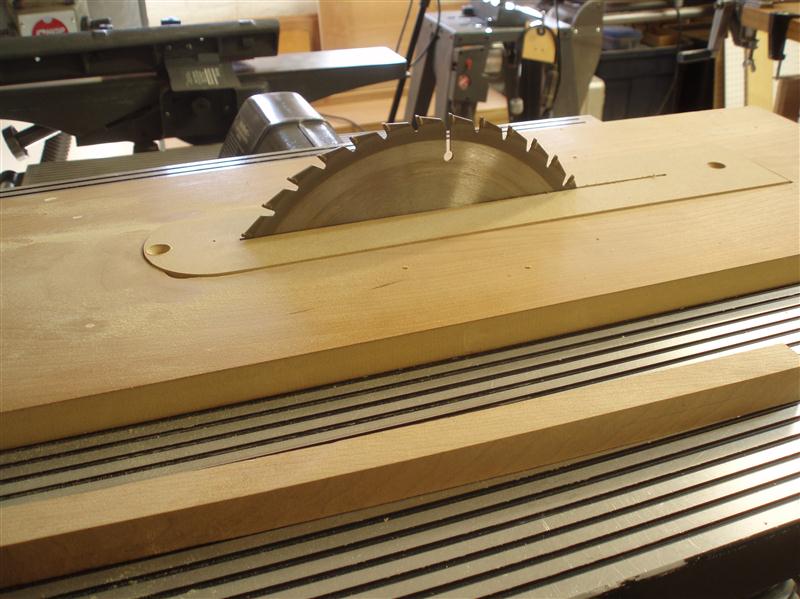

I suppose that is essentially what I have been doing for twenty years and I decided that, with a little bit of extra work, there was a safer and more accurate way to do this.
The beauty of this forum is that you get to criticize anything you want or ignore it all together.
Besides that - there were a few lessons that I needed on use of the plunge router.

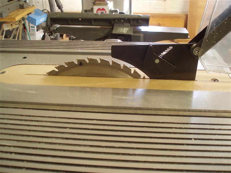

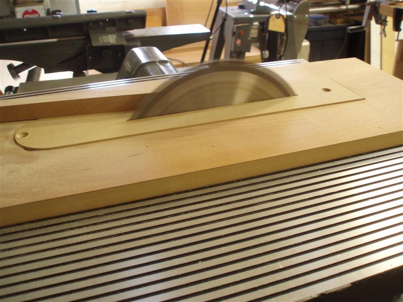

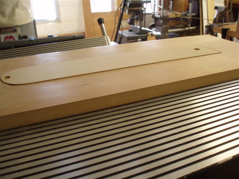

[ATTACH]16122[/ATTACH]
[ATTACH]16123[/ATTACH]
[ATTACH]16124[/ATTACH]
[ATTACH]16125[/ATTACH]
[ATTACH]16126[/ATTACH]
Sled is not quit done. Still need the proper ZCI hold downs.
PS: Viewing this post I now realize that I don't need to lower the table that far to cut the insert. I can simply adjust the slide stops (on the sled) to get the right length kerf. Having that much blade above the table always bothers me.
Ready for an Insert (Custom).JPG (82.75 KiB) Viewed 2952 times
Insert Ready (Custom).JPG (80.01 KiB) Viewed 2949 times
Lower the Table (Custom).JPG (82.19 KiB) Viewed 2951 times
Slide the Sled (Custom).JPG (78.99 KiB) Viewed 2951 times
Ready for Work (Custom).JPG (74.26 KiB) Viewed 2953 times

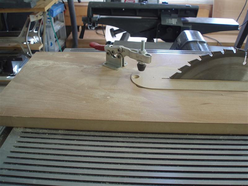

These are the hold downs that I decided to use. They have been in the grab box for a long time. Don't know why they haven't been used before.
[ATTACH]16127[/ATTACH]
[ATTACH]16128[/ATTACH]
OKAY JPG. I am ready. Sock it to me. Give it your best shot.:)

dusty wrote:These are the hold downs that I decided to use. They have been in the grab box for a long time. Don't know why they haven't been used before.
Looks good to me!]have[/B] this it is a no-brainer to decide to use it.
Is it necessary? Probably not but it IS a better way to cut them.:cool:
As seldom as I have made them, it would be overkill for me, but those who do this often should give this serious consideration.
No 'shots' justified!
