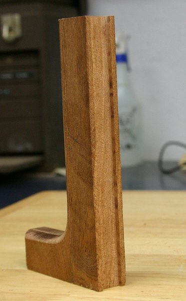

Got the router work done on the set up gage body tonight. This included both the round over and groove op's. Both were really much easier than I expected.
Here's my set up for the 1/8" deep x 1/2" wide groove. Used a 3/8" straight bit set just over 1/8" from the fence. On my scrap set up pieces, determined that I needed 4 sheets of paper against the fence to serve as shims to get the end lip real close to 1/8" shown in the design. I know it's exact dimension wasn't critical but I wanted to see how close I could hit it. Came out just over by a few thousandths.

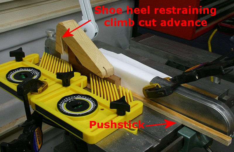

Made the first pass using this 'high heel shoe' to feed the part AND hold it down.
[ATTACH]9553[/ATTACH]
To get the groove centered, the part was flipped and the other end run through without changing anything in the set up. The instructions didn't mention that when you flip the part, the second cut ends out being a climb cut so the part wants to shoot out the back of the router table. I found that out on my first scrap set up piece. So that it didn't happen on the actual body piece, I used two hands, one on the infeed pushstick to advance the part and the other on the outfeed shoe to restrain the part from just shooting out the back. Advancing slowly, it felt very controlled doing it this way.
[ATTACH]9554[/ATTACH]
Being my first groove, I don't know what they are supposed to look like but to me, this one looked SWEET!!!! Correct depth, smooth bottom, and both side ribs equal width.
[ATTACH]9555[/ATTACH]

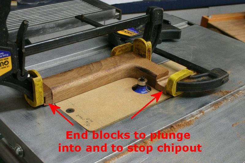

Of the two op's, this one worried me the most. I wanted to make sure the pinkies were safe. Having never done this before, I didn't know what to expect. As it turns out, it was a piece of cake. On my practice piece, I first tried table routing with only half the bit raised. I didn't feel any resistance at all and it cut very smoothly across the grain. I raised the bit up all the way and repeated a practice pass where I started by plunging into end grain slowly and again, hardly any resistance. That was enough to tell me that I should be able to do it safely. Here's how my set up looked.
[ATTACH]9551[/ATTACH]
I clamped end blocks on the starting and ending corners. The clamps were my 'handles' keeping my hands completely away from the bit. The first edge pass came out great. I got some burn after coming around the radius and hitting the cross grain. I might have slowed down?? or can that be considered normal??? or a sign of cheap bit???
[ATTACH]9550[/ATTACH]
Got a little burn onthe radius on the other edge. Again, not sure if I slowed down or if it's normal.

Clean the shaper cutter real good before rounding the other half. MAY reduce burning.
While measuring the 1/8" lip, be sure to as accurately measure the 'removed' part. That is the critical dimension for the mating 'projection'. Cut this second(mating) piece slightly large, and approach the fit by light sanding of both pieces. This allows you to selectively attack the 'high/narrow' areas. Finish off with steel wool. As it ages(swells/warps) you can again use steel wool as appropriate.

The "burning issue" is one good reason to have a variable speed router.
You can usually avoid it also by leaving a thin final cut and running it, particularly over end grain, quickly.
