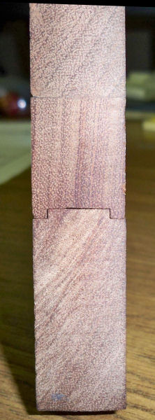

Completed the tongue on the sliding arm tonight and managed to get it roughed out to shape. Haven't had much time to work on it over the past couple days but found a couple hours tonight.
My first attempt at the tongue a few nights ago was going well until.........my mickey moused, manually clamped down temporary wooden fence moved while I was routing. The tongue went way undersized. Fortunately there was plenty of extra stock so I was able to cut it off on the table saw tonight and start over. Got the idea of the clamped down fence from reible's post above but I used ratchet style bar clamps with the rubber feet and they obviously weren't tight enough. C-clamps would have been a much better idea.
Here's the setup I used. ER10 with home built undertable router, 3/8" straight bit, featherboard, 'high heel' shoe, fence, 12 paper shims, and an axillary fence. This time, I backed up the wooden auxiliary fence with the standard metal fence to reduce the risk of it moving. Also gave a nice nesting area for the paper shims.
[ATTACH]9613[/ATTACH]
I didn't trust doing it without the featherboard. Not enough experience.
The plan showed the tongue edge 1/8" from the side of the part. I initially set up the router bit to extend out from the aux. fence visually just over 1/8". I then placed 12 layers of of paper between the regular fence and the auxiliary closing the distance down. I knew the tongue would be too wide at this point but it gave me a safe starting point making sure I didn't cut off too much material. I would make a pass, turn the part 180 and repeat then check the fit into the mating groove. Then removed 3 sheets, repeated and checked the fit. As it visually got to be a close fit (with NO measuring shipwright :D !!!), I'd remove 1 sheet at a time and run both sides through the router again. Finally, after removing a few more single sheets, the joint went together with a real nice fit.
[ATTACH]9615[/ATTACH]
[ATTACH]9614[/ATTACH]
Next steps will be the quarter round over op, and adding the groove / screw / thumbscrew knob for sliding the arm up and down and locking it in place.

I committed to going by eye and feel to break my time consuming measuring habit. I just had to show shipwright I could do it. :p On the first tongue I made that I screwed up, I was spending too much time measuring and not having any fun with it. I was noticing that there was poor correlation between paper shim removal and resulting dimensional change. Paper measures ~.003" so I'd expect ~.006" change for each sheet removed. NOT!!! Sometimes it was .010", other times .001". There were other process gremlins in there accounting for variability (including the measurement process) and rather that see it and try to fix or understand it, I figured what I don't know won't hurt me. Another factor that made me comfortable with not measuring was the fact that on the first tongue where the fence moved and made it undersized by about 1/32", it really wasn't that sloppy in application. A 32nd" gap over a couple of inches (with gage in fully up position) really doesn't trig out to be a large angular variation. I almost decided to just live with it as is BUT, the quality control angel got the best of me.
p.s. I measured it just now and the groove measures .516" / .523" and the tongue measures .509" / .511". (sorry Paul but it was an after the fact thing vs. real time so I am making progress.)

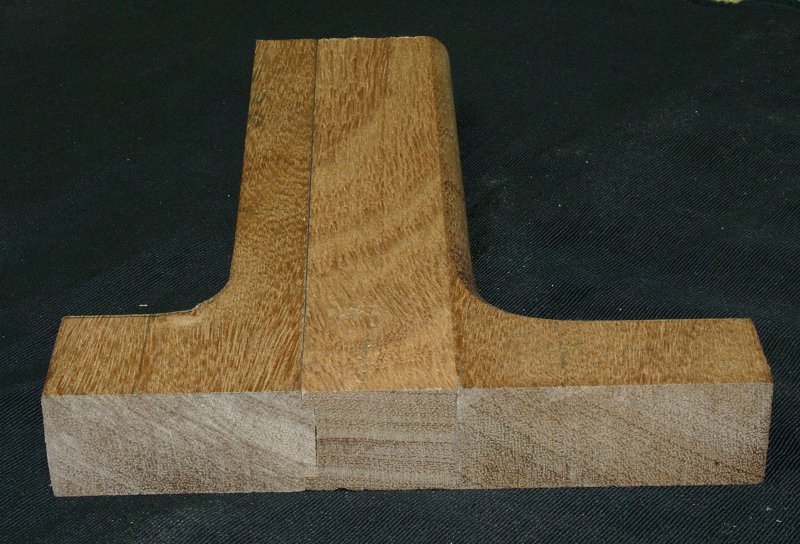

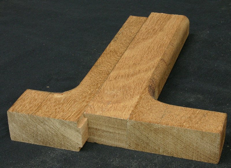

Here's a dead on shot showing the 'chasm' which surrounds the tongue. The gap is much more obvious in this shot. In the photo I posted last night, I had just disk sanded the two halves as a pair and I don't think I even took them apart before taking the pic. I was so awesomely impressed with how nice it looked, I put it down on the benchtop and shot it. Maybe (most likely) sawdust masked the 'chasm' to some degree.
[ATTACH]9625[/ATTACH]. . . [ATTACH]9627[/ATTACH].
And FYI.....a localized measurement right at the face shown in the photo is tongue .510", groove .521".
