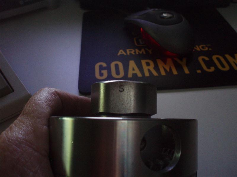

Brace yourself. Here comes some double talk. Having an Adapter stamped with a "F" apparently doesn't mean you have the wrong Adapter. Check the photo images that reible posted (this thread). His Adapter is stamped with an "F" and his is correct.
The Shopsmith related information on some of the Teknatool web pages can be very confusing.

Hey Dusty, I can take a picture of my mousepad too!
