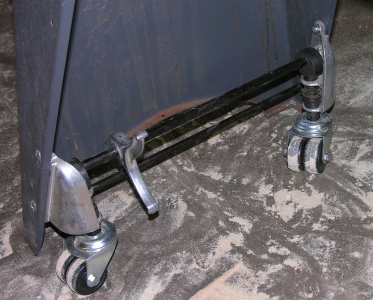

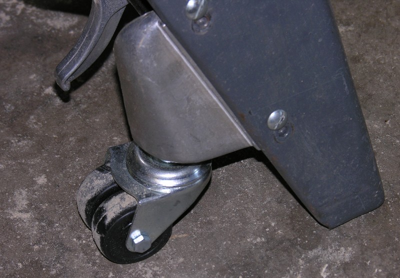

For what its worth........this thread has several miles on it, but I will add another little twist anyway. I am always looking for an easier way to move my machines around. The dual casters slip right in although you will need to reset the Retractable Caster Assembly 5/16 inch higher on the legs. Setting the 520 on a couple of saw horses and removing the legs to drill the holes, install casters and remount the legs took about 1 1/2 hrs. The casters have double ball bearings so it is easy to move the 520 in any direction.
The casters are from McMaster-Carr product #87855T61
Pics will probably make more sence than my explanation.

Do they have to be set higher because the wheels still touch the floor when the wheels are retracted?ldh wrote:For what its worth........this thread has several miles on it, but I will add another little twist anyway. I am always looking for an easier way to move my machines around. The dual casters slip right in although you will need to reset the Retractable Caster Assembly 5/16 inch higher on the legs. Setting the 520 on a couple of saw horses and removing the legs to drill the holes, install casters and remount the legs took about 1 1/2 hrs. The casters have double ball bearings so it is easy to move the 520 in any direction.
Dusty,
Yes you will need to set the caster frame about ¼" to 5/16" higher with the double wheels. Remove the caster frame and measure with the SS casters then with the McMaster Carr casters and you can determine the difference. I have done a couple of sets now and found one to be ¼" higher and the other was ok at 5/16". I am about ready to put a set on a 520 that I use here in Phx. and I have a little modification that I plan to add to that install. I will post some pics when I finish.
ldh
