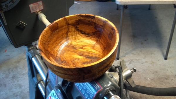

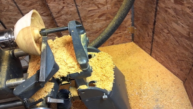

No 7 in the bag is from Bodark wood. It was given to me by a co-worker and is supposed to be green but it's hard as a rock to turn. It's also a vivid yellow. It will be interesting to see how it looks when dried and finished.
[ATTACH]20652[/ATTACH]

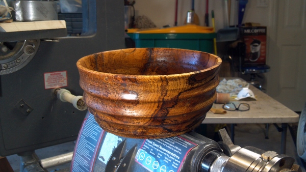

I wonder what color this wood will be when it dries and is finished. I have enough to make 3 more bowls.
[ATTACH]20653[/ATTACH]
My chip/shaving containment system in action.
[ATTACH]20654[/ATTACH]
Bright yellow shavings from Bodark tree log.

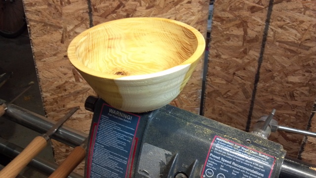

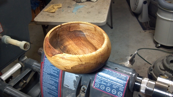

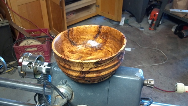

First 2 bowls out of the bags that have been drying since January. One has a small crack, the other is crack free. I still have a lot to learn about style and finishes.
[ATTACH]20968[/ATTACH]
Crack free
[ATTACH]20969[/ATTACH]
[ATTACH]20970[/ATTACH]
[ATTACH]20971[/ATTACH]
Small crack that I filled with CA glue to stabilize. I was planning on performing the final turning but it warped too much so I just sanded it and called it finished. The walls are thicker than I wanted. I think I will turn future green wood down to the final thickness and take my chances with cracking if they are going to warp bad enough that I can't finish turning.
