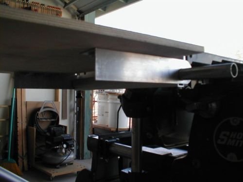

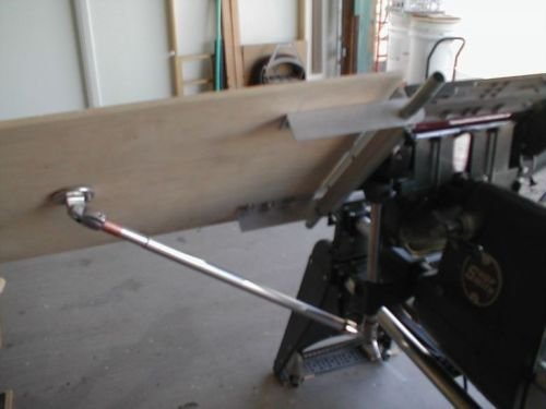

With the 520 Table and Pro Fence system you have a couple of options for outfeed tables that can move with the setup. The first is shown below and is a modified version of the outfeed table Shopsmith used to sell. The leg has been changed to attach to the bottom of the Table tube. This setup moves not only up and down with the table height but also tilts with the table.

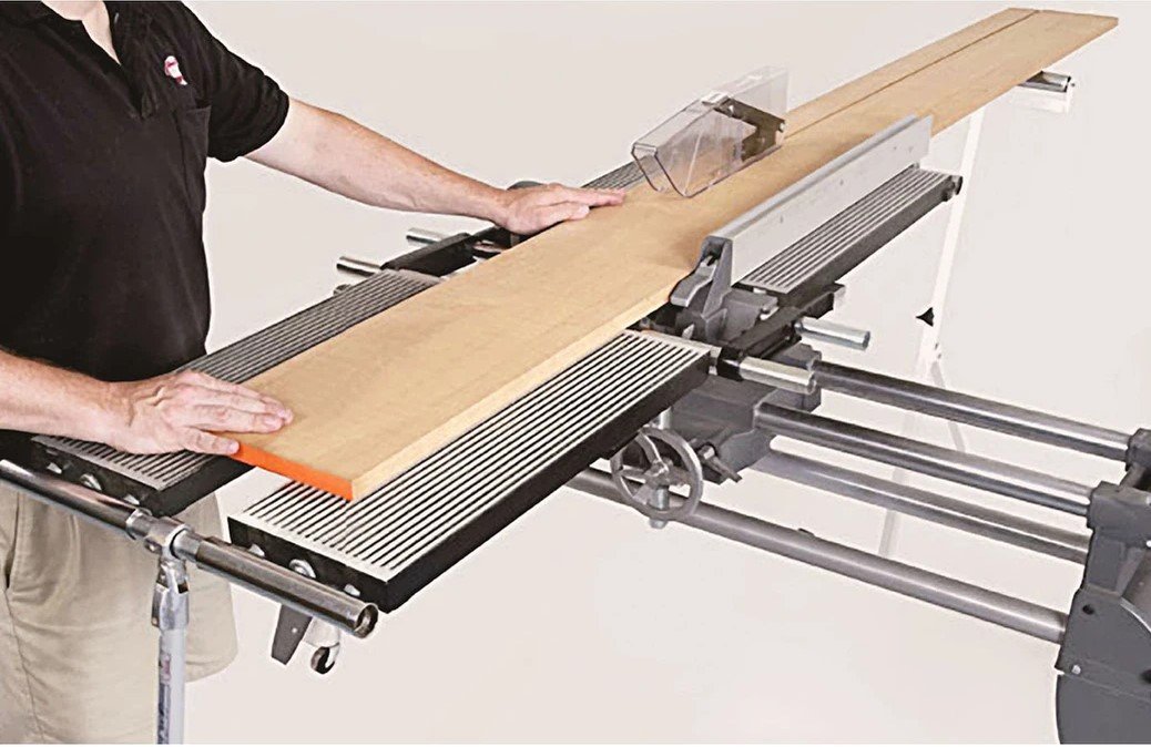

The Mark V 520 (and the 510) can use the Floating Tables for both infeed and outfeed extensions. Shopsmith sells brackets for direct alignment or you can use them offset without the brackets. The picture below shows the Brackets part number 555997 in use as an infeed table. These two methods do require adjusting the support leg's height with the table height. The more Floating Tables you have the more infeed/outfeed options you have.
_
- 555997 Table Extension Bracket Set - infeed.jpg (113.39 KiB) Viewed 58753 times

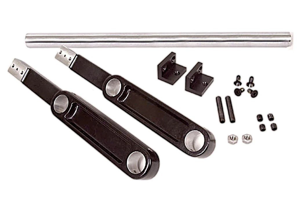

below is the brackets themselves.
_
- 555997 Table Extension Bracket Set.jpg (68.04 KiB) Viewed 58753 times

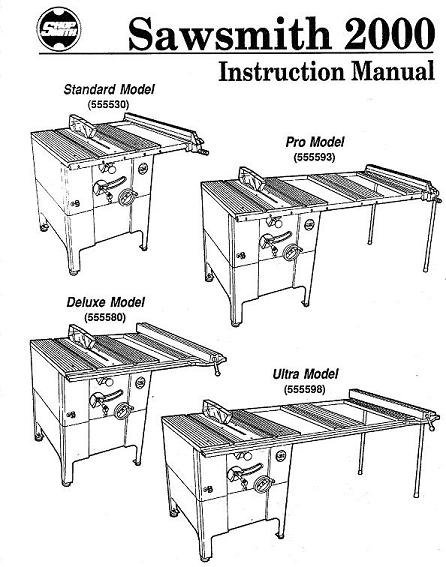

The Sawsmith 2000 does have that sliding blade feature, but the blade does lock in place for regular table saw cuts. The Sawsmith 2000 was made from January 1985 until sometime after November 1993. I don't know exactly when it was discontinued. Parts must be found used for it. There were 4 models varying in the fence and table width.
_
- Models of Sawsmith 2000.jpg (57.11 KiB) Viewed 58753 times

lldeman,
The first outfeed Table Extension in my previous post is based off the one Shopsmith sold. In the case of the one in the picture the person made their own brackets to attach it to the 520 Fence Rails. The same can be done for the 510 Fence tubes but the bracket would not be interchangeable between the 520 and 510. Aluminum angle brackets were made along with the tabletop having groves for the Miter to pass into. I believe this one is using a Shopsmith adjustable leg and swivel end attached to a rod that goes up into the end of the Table Post. A rod of the correct length can be used instead of a Shopsmith Adjustable Leg since it is a fixed length. An additional swivel, wall type, end is needed to attach to the bottom of the table.
Below you can see the leg arrangement and how a connector tube holds the bracket to the Fence Rail.
_
- outfeed table 2.jpg (21.33 KiB) Viewed 58691 times
Below is a closer view of the bracket.
_
- outfeed table 3.jpg (21.95 KiB) Viewed 58691 times
