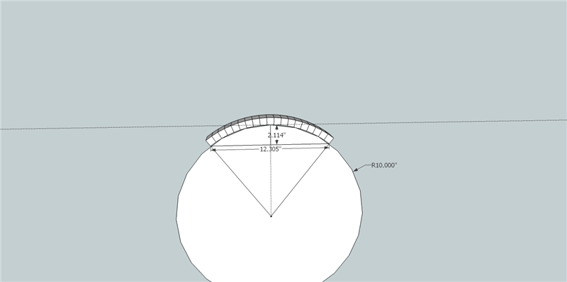

This is getting really funny now.
If we are not all attempting to do this with the following dimensions, if is no wonder we get different results.
[ATTACH]24126[/ATTACH]

You are right on.edflorence wrote:Wow, this discussion has gotten pretty numbers intensive...So, I thought I would contribute a formula I picked up a while ago that really helps with laying out these circular segments. I found it in a reprint of Popular Mechanics "Shop Notes" from 1907.
Post # 22 includes the .pdf with the info for building the arch on which the slats are to be placed during construction. Using the dimensions given in that post, and the Popular Mechanics formula, the radius of the curve can be determined as follows: Take (1/2 chord distance), square it, then square the height and add the two results together. Finally, take that sum and divide it by twice the height. The result will be the radius of the curve, which in this case turns out to be a bit less than a 64th over 10 inches.
You now have enough information to layout a full size drawing of the arch on which you can then draw the slats and determine the correct angle for setting the table tilt.

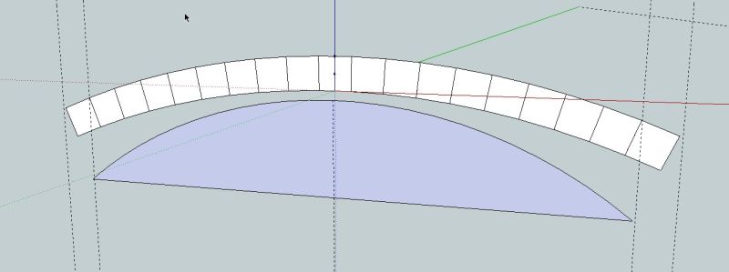

Our numbers are close but I doubt that we will ever determine which are closest to correct.
I believe this to be my last shot at this.
[ATTACH]24127[/ATTACH]
- A Nineteen Piece Segment 2 degrees (Custom).png (26.85 KiB) Viewed 929 times
