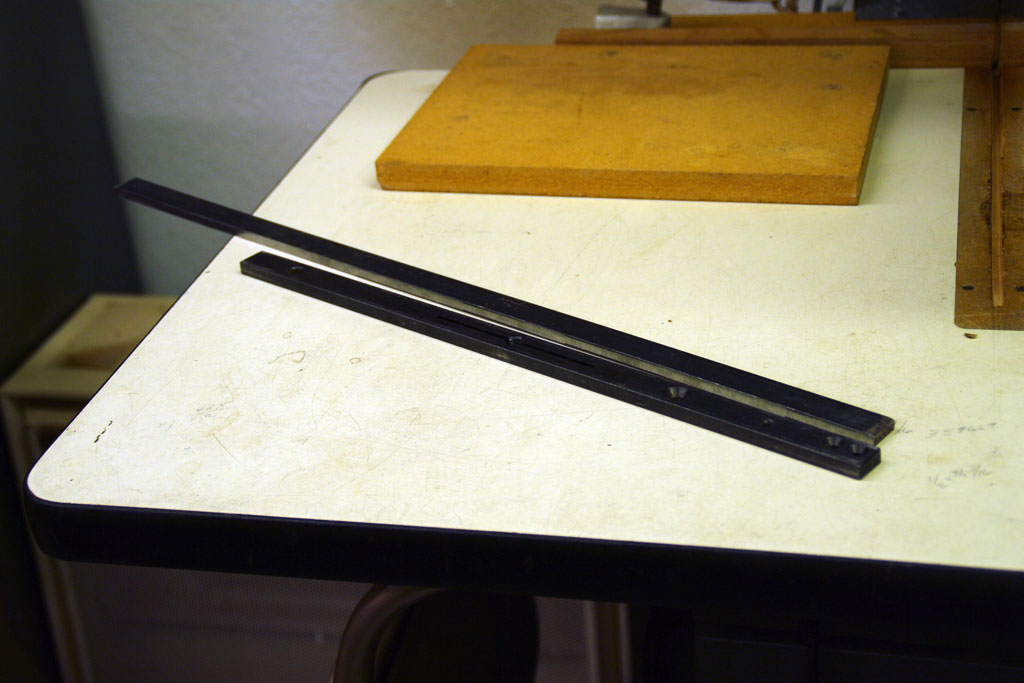

I spent the afternoon working on the router table. I wanted to come up with something to fill the miter slots from end to end. Problem: SS miter bar is .310 deep, .729 wide. These are Bastard dimensions as far as finding bar stock to fit. I went to the local steel outlet and bought 10' of 3/4" x 1/4". Ran into a problem, the stock was extremely hard. It was supposed to be cold roll but those things happen. 40 miles round trip I made do. Milled it on both sides to get .729. .006 clearance. I am going to use a .060 Lexan shim either under or on top of the bar so it will be even with the top of the table. Probably will put it on top because is "Slicker".
[ATTACH]24390[/ATTACH]
[ATTACH]24391[/ATTACH]
Don G
Don G

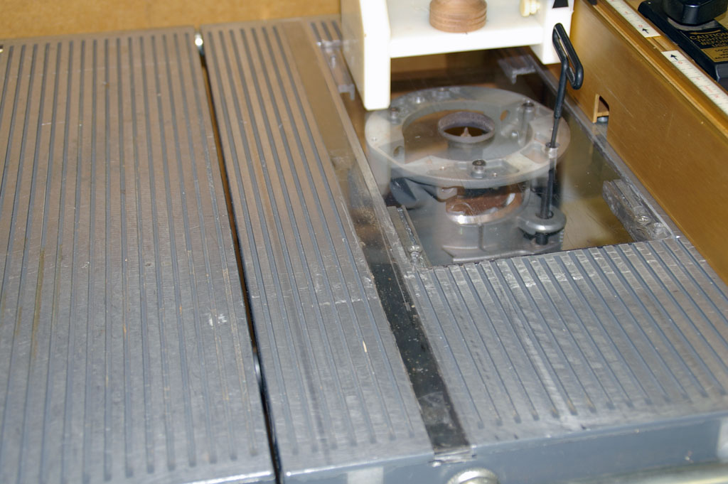

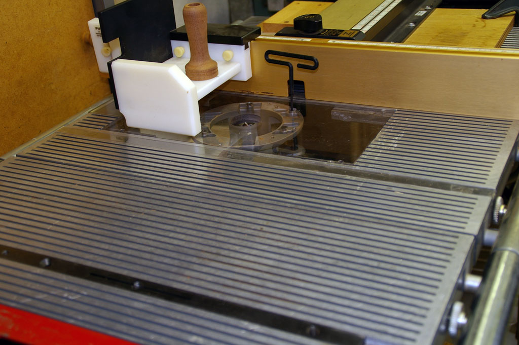

I got one filler bar made. Installed the Lexan shim on top of the bar to obtain table height. As hard as the bar was I may not even make the other one until I locate some cold rolled steel or possibly aluminum.
[ATTACH]24397[/ATTACH]
[ATTACH]24398[/ATTACH]
Don G
Don G

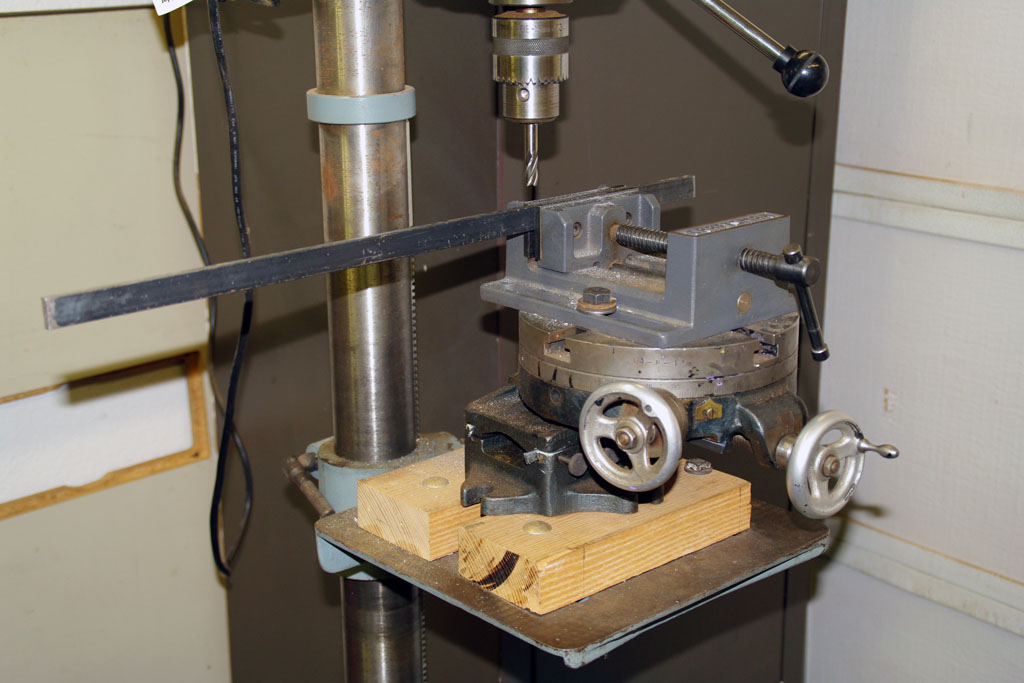

Nice xfer* vise! Slobber Drool:D
As for the bar thickness, thinner will still work. It does not need to ride in the bottom of the slot. The slot is wider there any way and will not help alignment. That would mean it needs to slide on the table surface.
* make that 'rotary'. Does it move horizontally as pictured(as I assumed at first)?
Yes it does. It's a X-Y as well as a rotary. It's one of the best additions to a shop you can have. I have used this thing for more projects than you can believe.
I am not sure I understand using the thinner stock? All I am trying to do is replicate the original dimensions of a stock SS mitre bar full length of the slot. But I want it "Flush" with the top of the table. SS obviously used "Bastard" dimensions to keep the mitre bar proprietary which is a normal practice to protect their product from "Cheap skates" like me.
The filler bar is not meant to slide, but to stay fixed in the slot. However, it can be removed so the SS mitre can be used if the project needs it.
