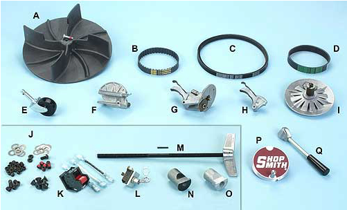

I do not believe that Shopsmith has called out any part numbers that reference a nylon patch. I say this even though I have set screws in my possession that have the nylon patch and I don't recall having ever purchased set screws from other than Shopsmith until now. Said another way, I believe the set screws that have the nylon patch (mine are red) came to me in the Help Kit. One MIGHT therefore conclude that Shopsmith recommends the use of the nylon patch in some limited applications.
PS: I just now noticed this subtle bit of information. Examine the set screws showed in the attached image of the most ordered parts from Shopsmith. Six set screws with a red nylon patch. The Help Kit contains six each of 5/16"-18x3/8" socket head screws.
[ATTACH]25456[/ATTACH]
According to my notes, those set screws are used 1 each in the drill chuck (299), and sanding disk (325) and 2 each in the strip sander (40) and jointer (8) and 4 each in the belt sander(10).
