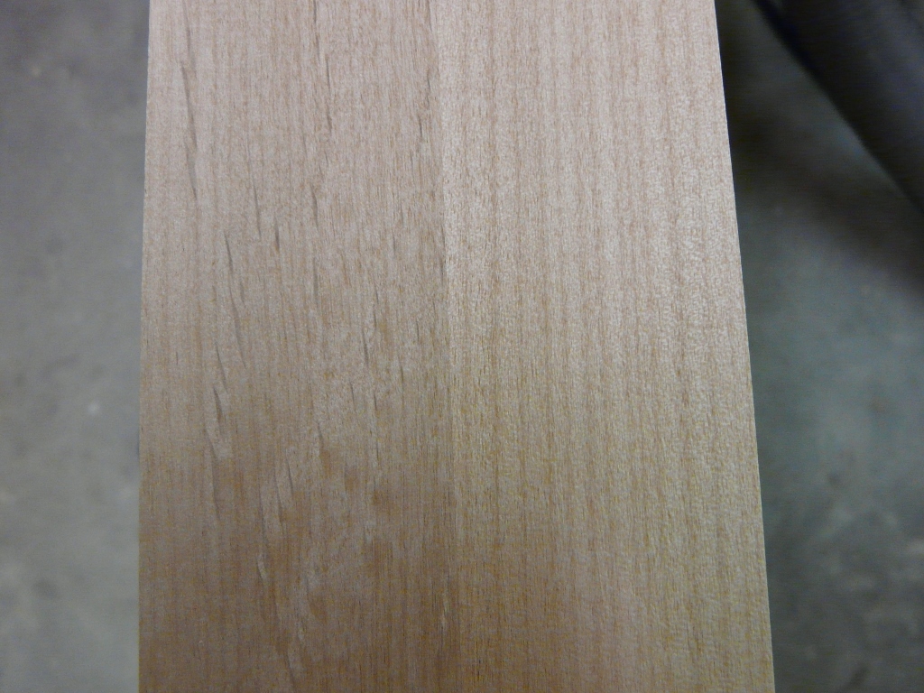

Not sure how well this will show up but this is the quality of the cut with new knives.

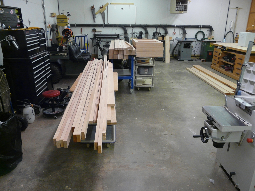

Parts are starting to stack up but I am still waiting on some more 8/4 alder to come in.

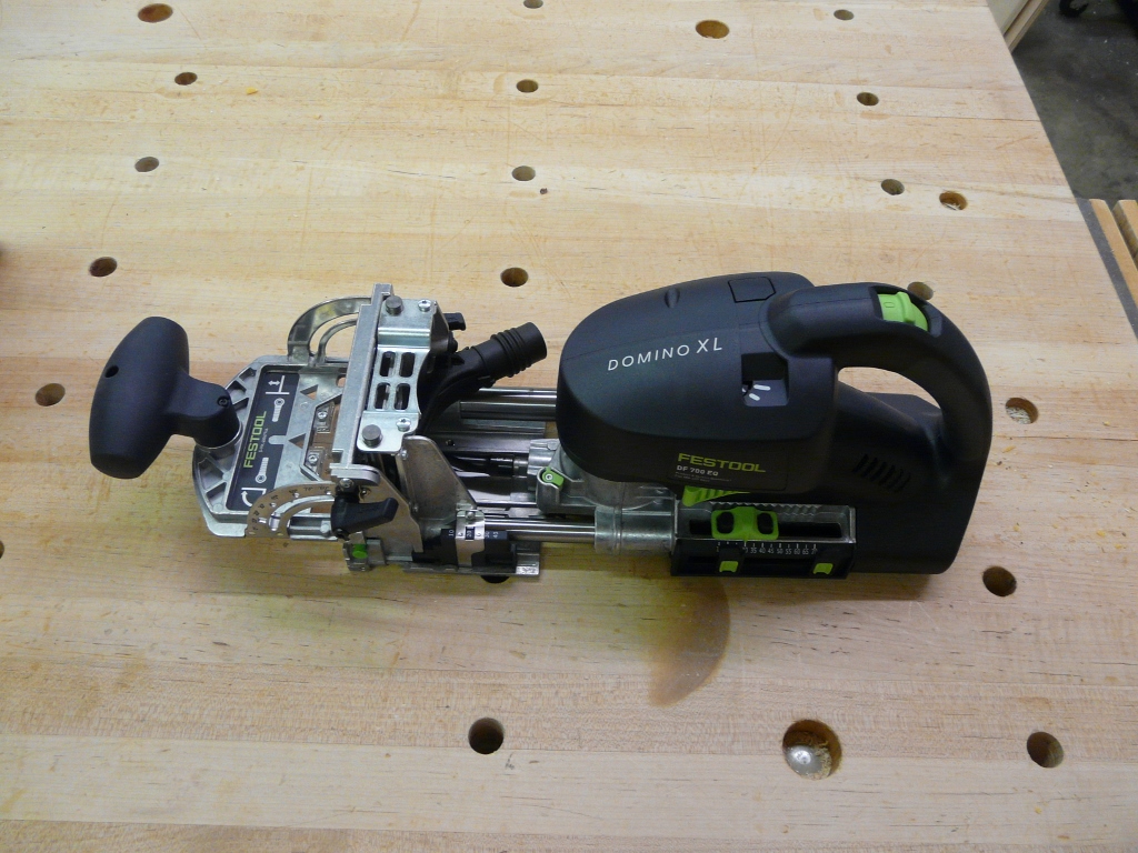

Tomorrow we will check out this brand new BAD BOY.
https://www.youtube.com/watch?v=8CbWvbuL_u8
Mark
2017 Power Pro Mark 7
Re: Occasionally In The Shop
Previously missing pix are back. That was quick!
mbcabinetmaker
Posts: 1627
Location: Greer SC
Post by mbcabinetmaker »

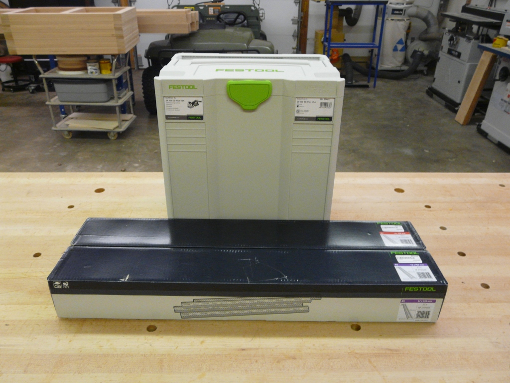

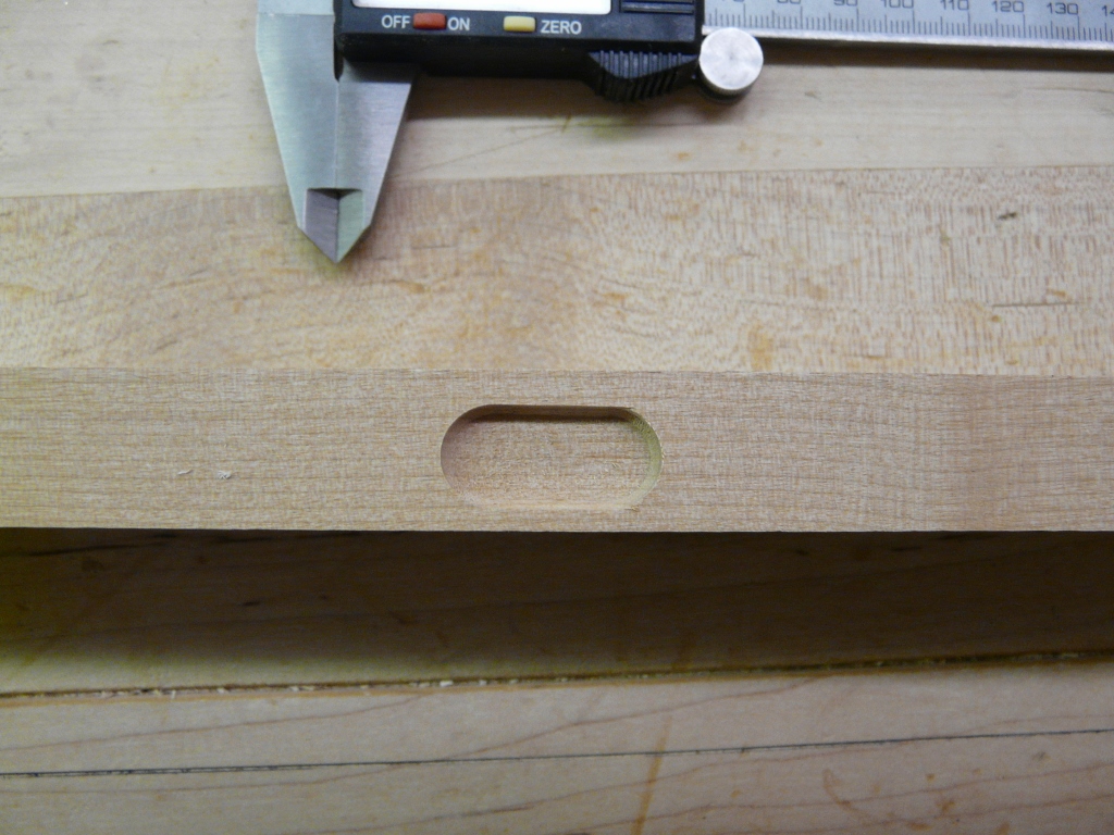

The good news: This thing is designed for large stock.
The bad news: This thing is designed for large stock. I am a little disappointed that it will not punch the center of a 3/4" board. :( That means we are going to have to get a little farther along in the project before using it.
That's one long domino!
At least it came with a new decal for the tool box lid. Actually I think it was designed to go on a lighter surface. Oh well to late. :rolleyes:

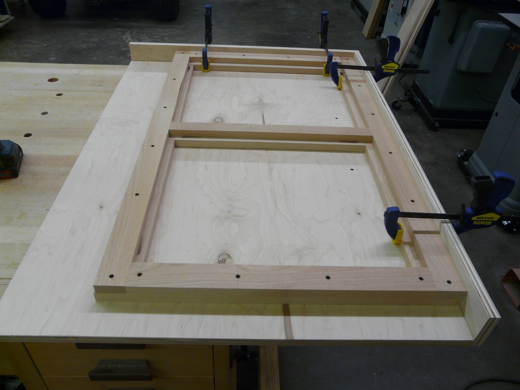

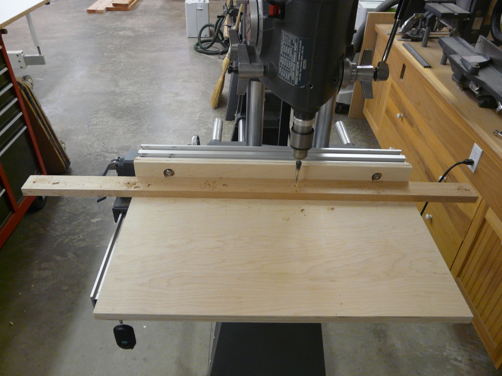

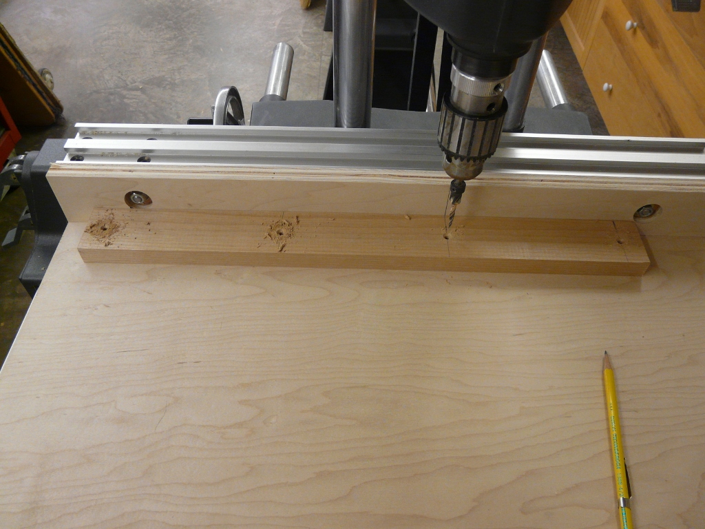

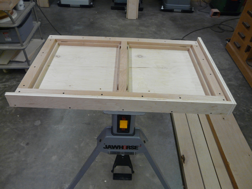

So I decided to make a new jig for drilling on the 520.
Lots of holes to drill and keep them from interfering later with the domino's.

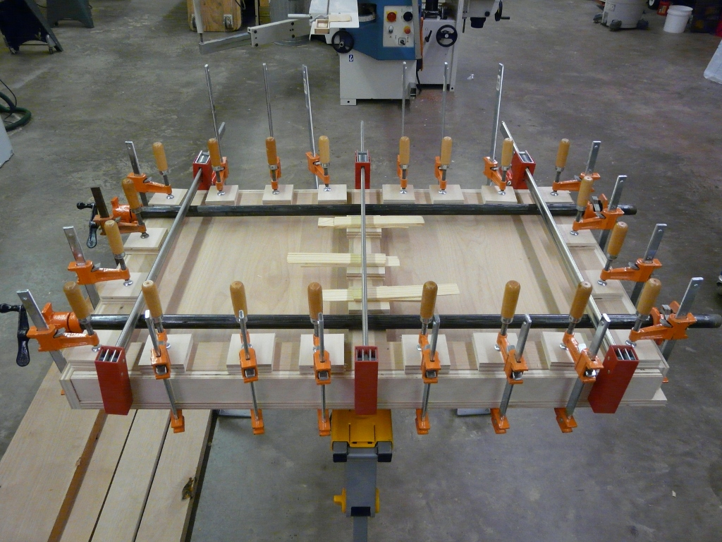

I also made an assemble jig for these panels.

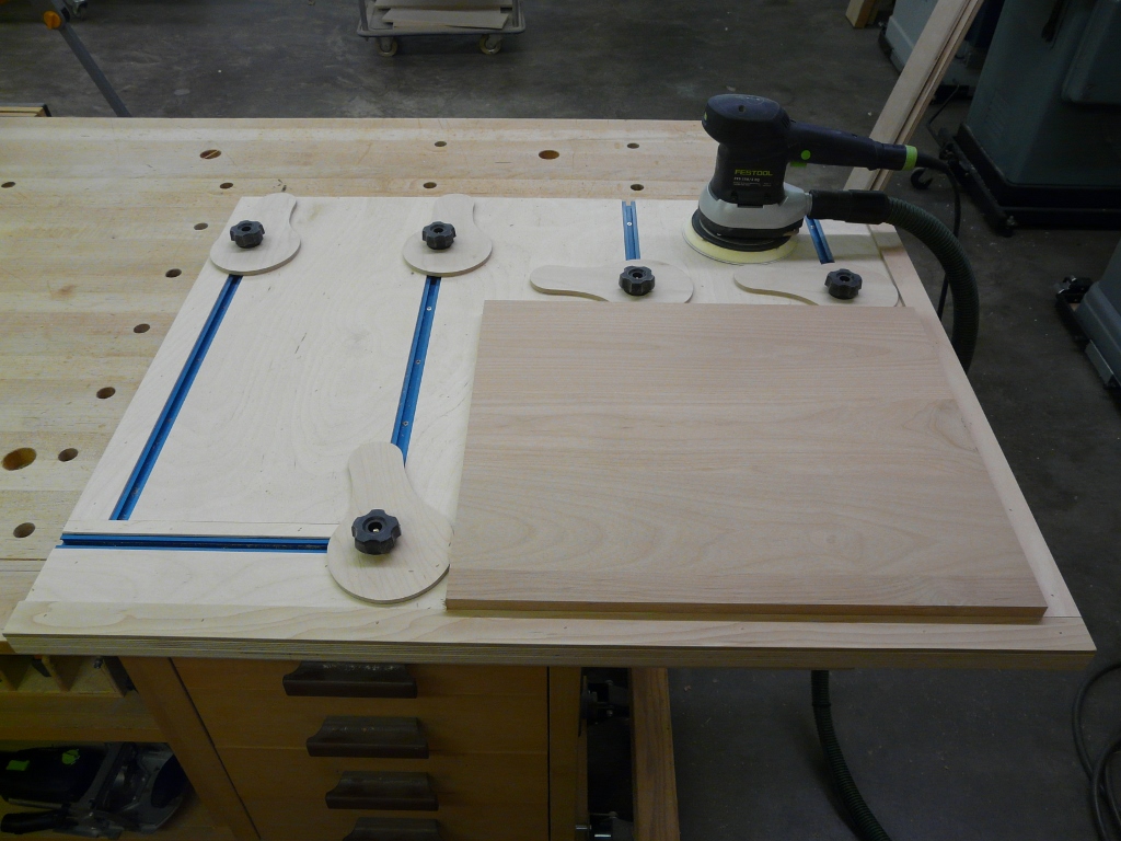

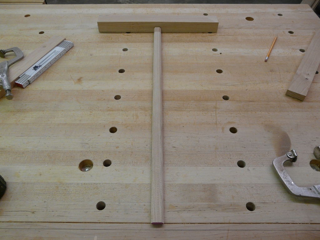

This is one of two sanding jigs of my own design that I made a while back. It is important to keep the items you are sanding from vibrating and jumping around especially on stain grade projects. If it moves under the sander it is creating sanding marks. This jig works very well. Pat applied for. :D

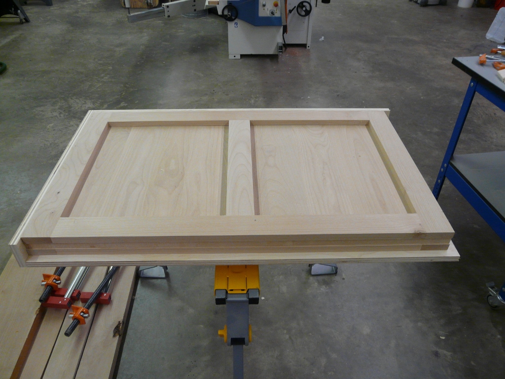

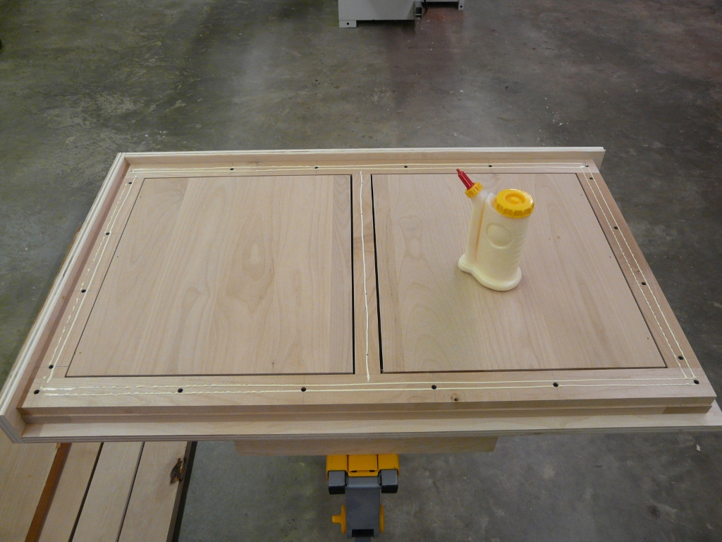

The glued up alder panels I made when you were not looking. :)

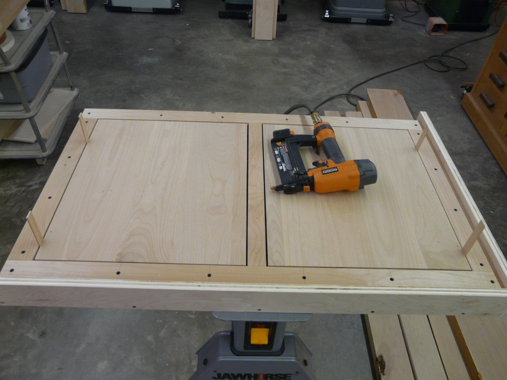

This is where I trimmed the assembly jig down and moved it to the Jaw Horse.
This will give more freedom for the clamps.
The glued up alder panels fit between two of the frames. Notice I have left room for expansion. I have nailed them on one side only to keep them square. That way they are free to expand and contract.
Ready for the top frame.
One down. Now I just need to repeat the process 7 more times. :eek:
No more tears gloves! :D
This time of the year my hands crack badly. :eek: Some times gripping the clamps and especially releasing them can bring tears to my eyes. :eek: :D
I bought these gloves at TS and the little gripping dots work very well and made clamping much more tolerable. :)

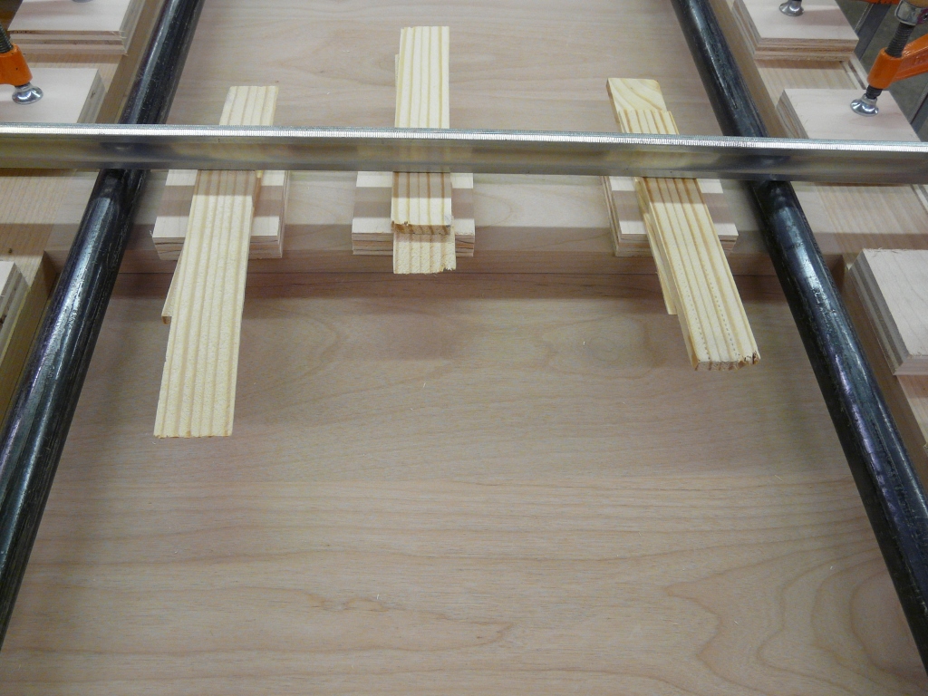

A little tip for clamping in the center of a panel.

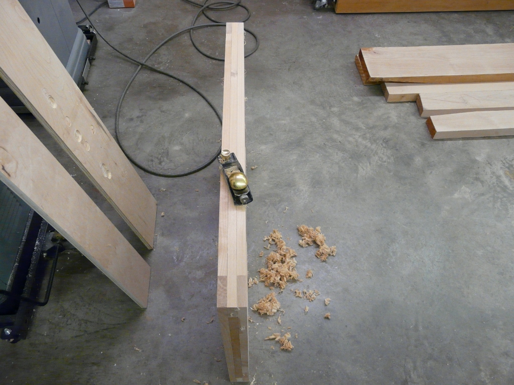

The bottom of these will be some what visible. They are to wide for the edge stroke sander but a little touch up with the block plane worked well. I will go back and fill the joints with Famo Wood for the final sanding.
