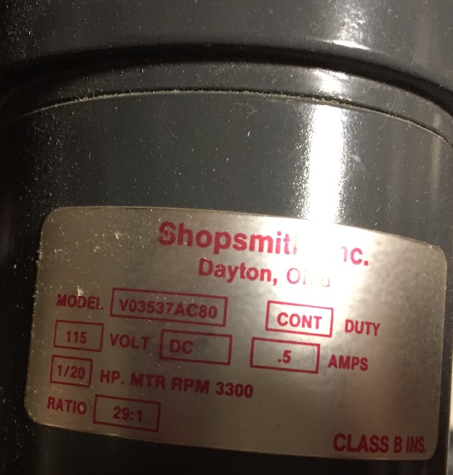

Those both are valid motors.
Everett
Everett

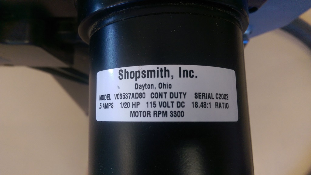

Re: Can a 12" Planer w/o feed motor be converted to manual feed?
No typo.jsburger wrote:JPG wrote:I tempted fate!
1/4 x 5/16 x 1/2 Measured 0.246 x 0.309 x 0.477
Brush retaining cap appears to be 1/2 - 32 thread(about 3 threads).
I did NOT pull the brush holder from the motor.
I do not know anything re vintage nor any history as it was an E-bay purchase.
The part # on the tag is VO3537AA80.
Mine is V03537AD80
Did you make a typo? If not I will pull one and measure.
However, I believe mine is from a SS mount planer in spite of it being black. History unknown(an e-bay purchase).
Additional info on the tag:
\gear ratio 29:1
Motor rpm 3300(at 90vdc I assume).
1/20 HP
90V .5A
Well Everett posted before I completed this post.
He posted a pix of MY motor tag!!!
I think the different gear head ratio illustrates the difference between the SS mount and the proplaner motor. Different speed range obtained.
The other one is mine. At least it is the same serial number. So I will pull a brush and see if it is the same size as yours.JPG wrote:No typo.jsburger wrote:JPG wrote:I tempted fate!
Mine is V03537AD80
\gear ratio 29:1
1/20 HP
90V .5A
He posted a pix of MY motor tag!!!![]()
- IMAG0187.jpg (112.01 KiB) Viewed 19411 times
Here is a 3rd model V03537AC80
Everett
Everett
And the B
So it looks like the A and B models are the early SS mounted and Pro planer motors and the C and D models are the later models for the same planers.
The 29:1 ratio is the SS mount planer and the 18.48:1 is the Pro planer.
