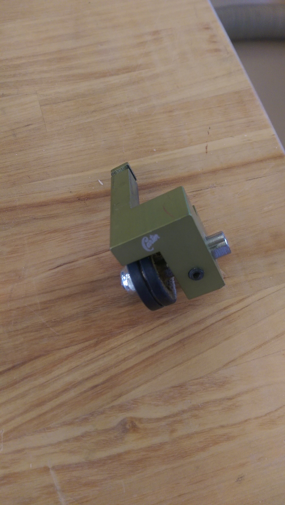

I agree with JPG on support of the back of the blade but I don't agree it eliminates the need for side guides. With a single bearing the back of the blade can slide back and forth across the face of the bearing resulting in the blade twisting slightly. With the grove the blade is held much truer but if you eliminate the side guides the front of the blade can still twist.
In fact that is exactly the principle of the Carter Stabilizer (not the Carter side roller guides). The stabilizer is used without side guides (upper or lower)and only on blades 1/4" wide or less.
From the Carter web site...
"The unique patented Stabilizer® from Carter is very different from any traditional guide in that it is not designed to hold the blade with immovable support on three sides. Instead, its grooved bearing wheel firmly prevents the blade from moving backwards or shifting left or right while still permitting the front of the blade to twist slightly side to side. This allows the user to make tight radius complex curves that no traditional guide system can achieve."
So yes you want three sided support. The single backup bearing only gives you front to back support and the double bearing gives you front to back and side to side support to the back of the blade.
As for cool blocks, they are OK. I used them for years before Carter came out with the SS roller guides. Cool blocks are soft and wear which requires adjustment and re-dressing the ends. The Carter guides are pretty much set and forget. I set the rollers to just barely touch the blade. With the saw running the rollers turn but I can touch them and they stop.
The combination of the double bearing backup and the Carter guides makes for a very stable setup. In my opinion blade stability is key to getting good cuts on a band saw. ANYTHING you can do to increase blade stability is worth it. The other component is of course good quality sharp blades.
Carter stabilizer.jpg (300.09 KiB) Viewed 2652 times
