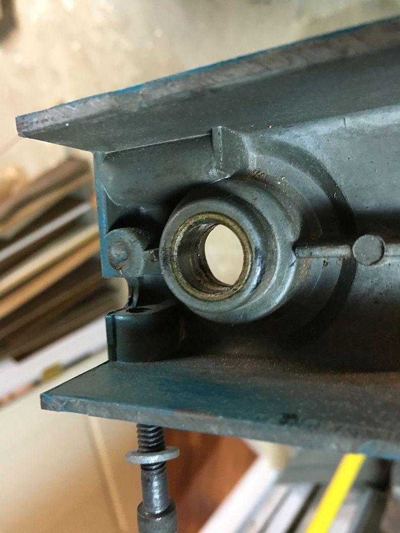

Wrong! Flanged bushing is on the DRIVE side casting. Washers go on arm side away from drive (casting side without flanged bushing). The pics were confusing because of rotation and angle of pictures, but note location of bolts securing casting to the base. I am reattaching and rotating photos to make a little more clear.
Drive side casting (lower bushing).
Non-drive side casting (lower bushing).
