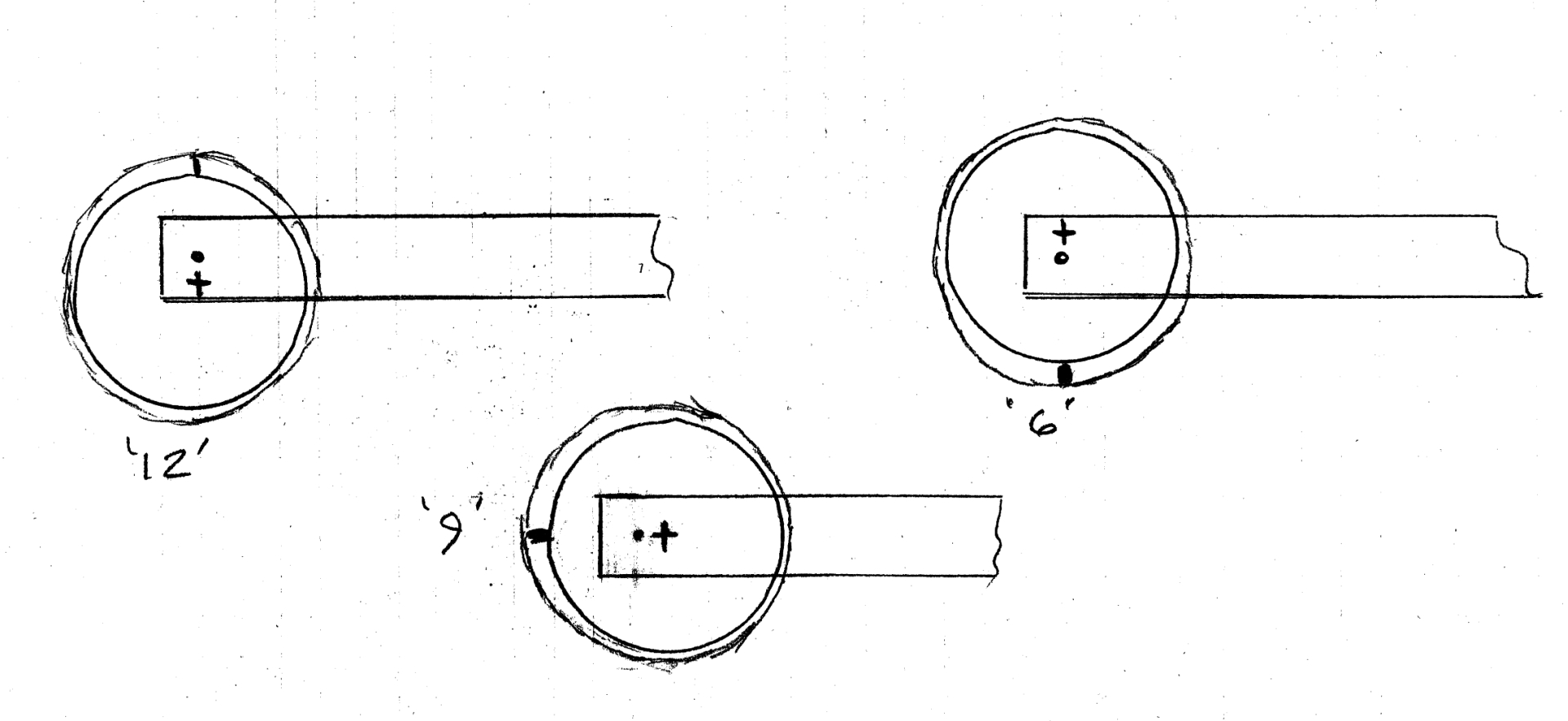

You got the idea, but that quadrant gear arm is horizontal.
eccentric vs button position.jpg (229.35 KiB) Viewed 4209 times
The 'dot' is the same location on the arm in all three views.
The '+' is the location of the bearing center.
Views are 6,9,12 o'clock setting of the wide part of the eccentric.
No genius, just a good understanding of the beast. ;)

JPG wrote:You got the idea, but that quadrant gear arm is horizontal.

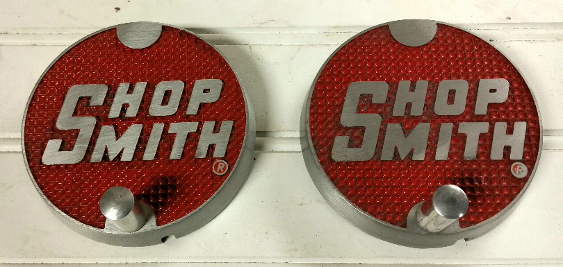

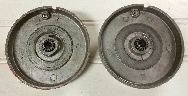

Speed Control handles back from Don Horne...1 week total time from the day I mailed them! Excellent job, like new (only better!) I would highly recommend him!
2016-03-18 19.42.48.jpg (114.33 KiB) Viewed 4144 times
2016-03-18 19.41.41.jpg (90.91 KiB) Viewed 4144 times
2016-03-18 19.40.37.jpg (107.46 KiB) Viewed 4144 times

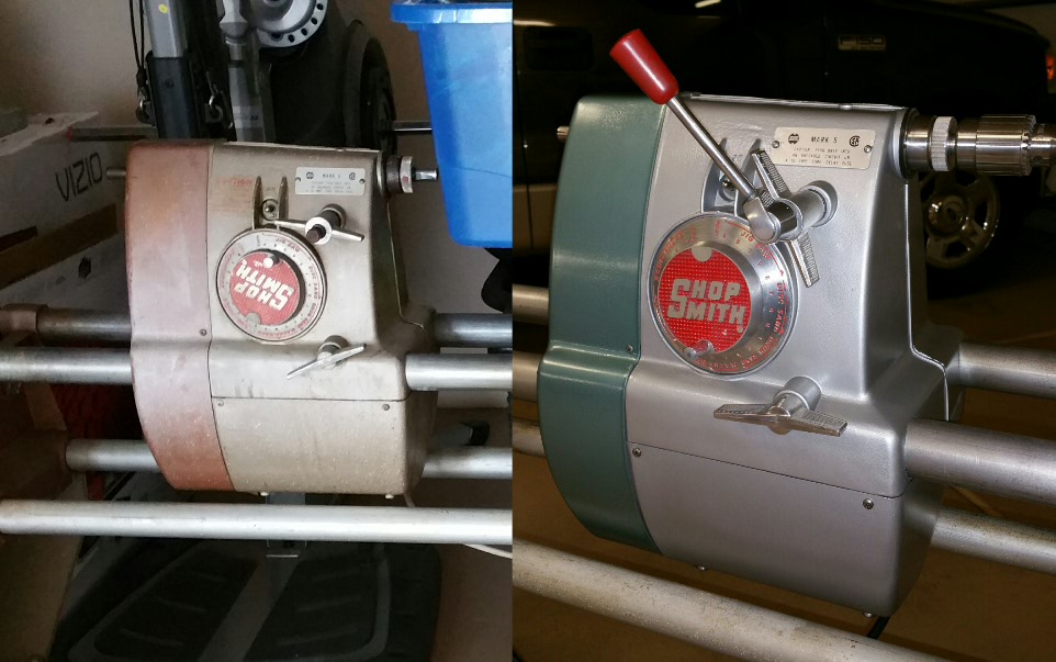

'62 Headstock finished except for warning decal...now I can polish all the tubes and move to the '56.
Before and After:
2016-03-20 14.58.50.jpg (124.92 KiB) Viewed 4110 times

silenthope wrote:'62 Headstock finished except for warning decal...now I can polish all the tubes and move to the '56.
Before and After:
Beautiful work. It looks great. One question, Why did you paint it as a Gernie when it began life as a Goldie? I don't think there were any '62 Grenies.
silenthope
Posts: 83
Joined: Thu Feb 11, 2016 12:29 pm
Location: Tucson, Arizona
Re: Goldie went Green
Post by silenthope »
jsburger wrote:One question, Why did you paint it as a Gernie when it began life as a Goldie? I don't think there were any '62 Grenies.
Ha! You're absolutely correct. (Kinda thought I would spark a "traditionalist" or two to chime in!) I apologize for the unconventional drift! I actually had a few reasons, albeit none that "justifies" the crime!
Here we go, for what it's worth:
1. I wanted to do a "test run" on the Greenie colors before I did my father's Greenie.
2. I didn't want to buy four different colors of paint! (Kinda lame huh!)
3. I thought it would be cool to have a pair of matched Mark 5's, despite the "generation" difference.
Thanks for the praise! It runs very well!
OK, at least you have a legitimate reason. Again a great job.
