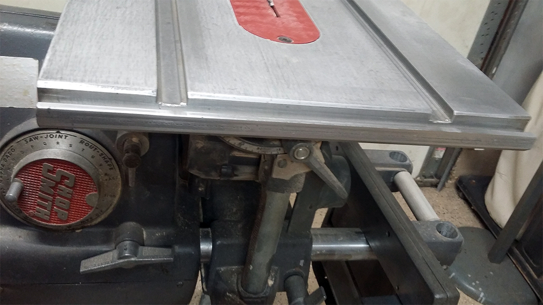

The front rail is not Scarred badly, very little in fact, see attached photo, I believe the problem was a combination of factors, it wouldn't release I believe because of a weak, in my opinion, spring nearest the locking knob, replacing it with a stronger spring helped there even if JPG thinks I was wrong in doing it, Maybe if I had removed the paint on the bevel portion of the fence, it might have made release easier, I don't know, but once clamped it liked to stay that way. IMPORTANT for those planning to TRY this modification, my UHMW strip is 1/8" thick, NOT a tape type strip. I saw something I didn't like and made a change that I am very happy with.

jjbuzard wrote:The front rail is not Scarred badly, very little in fact, see attached photo, I believe the problem was a combination of factors, it wouldn't release I believe because of a weak, in my opinion, spring nearest the locking knob, replacing it with a stronger spring helped there even if JPG thinks I was wrong in doing it, Maybe if I had removed the paint on the bevel portion of the fence, it might have made release easier, I don't know, but once clamped it liked to stay that way. IMPORTANT for those planning to TRY this modification, my UHMW strip is 1/8" thick, NOT a tape type strip. I saw something I didn't like and made a change that I am very happy with.

The rail looks much better than I imagined.
Paint on the bevel of the base?
Stronger spring ok as long as it is still weaker than the rear one.(affects clamping sequence)

The beveled portion of the "Rip Fence Base" is painted, the portion that comes in contact with the raw aluminum beveled portion of the front rail, this is that bumpy factory paint, not painted later,removal of that would make a cleaner surface for clamping. (I am going to remove it just to cover all bases) As far as the spring is concerned the "Fence Clamp" nearest the "Lock Knob" sometimes would not release, but would have to be wiggled loose, with the stronger spring, it releases every time. I had oiled it, etc, bit it continued to be problematic, not now.

It would appear the set screws were not the only 'quality assurance' issues with your fence. No wonder you were frustrated.
I am curious if the knob and rod and sleeve and pivoting clamp move freely.
I am wondering if you are in the habit of pushing the knob(as I presume you do with the 'other' fences). That would interfere with the spring releasing the clamp. 'Pulling' on the handle as it is loosened is a more typical way of using this fence as it pulls the 'bevels' apart.
