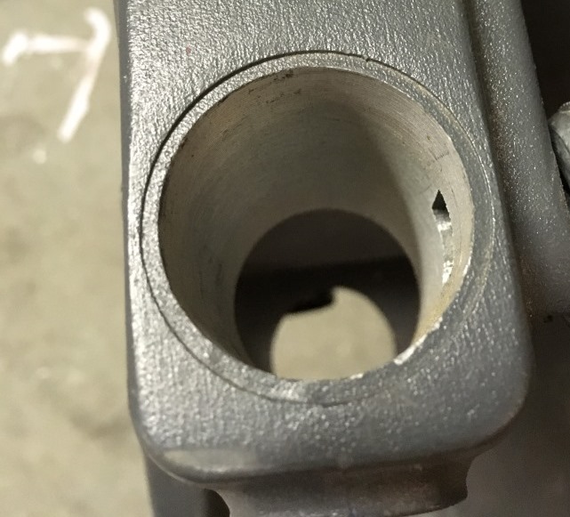

re-assembled with the new parts. I noticed the new part is closed out and doesn't allow for tube to interface with the legs. Maybe I wasn't the only operator who has had issues with this kind of a problem.

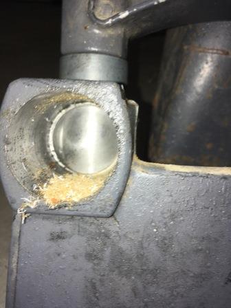

It sounds like gunk in the tubes and I personally would go to the store and buy some PENETRATING OIL. I wouldn't use any other kind of oil. It will say penetrating oil on the outside. Let it sit for awhile - maybe a minute, maybe an hour, maybe overnight. It should slide out unless there is other damage (like hammer blows). Once it is out, you will need to clean everything up making sure the slides and holes are cleaned first with penetrating oil, cleaned with a rag, and (I suggest) a little beeswax. You can use a drop or two of oil as well but it tends to collect dust.
I had the same problem and now I have a routine: Tighten the roller-bar by turning it towards the headstock, loosen by turning it away from the headstock. This works for either end.

br549
Posts: 657
Re: Tailstock stuck in MK V
Post by br549 »
I think I understand. If you look at one of his original pictures, with the way tubes removed, you can see the legs of the tailstock, so the holes in the casting for the way tubes and the tailstock intersected or met. In the part you sent him (and I just checked mine is the same), those holes do not intersect.
