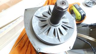

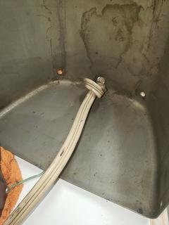

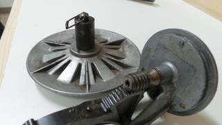

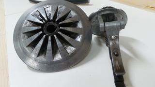

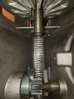

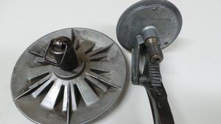

Went down to the shop took these pics. Might help I duno.
"The older I get..The better I was"
- Posts: 35451
Re: V-belt replacement
Take another showing the idler sheave and back towards the rear end of the idler shaft. Should show idler sheave, gilmer pulley/belt and casting with retaining clips.
I notice a couple of things(not necessarily related to belt problem).
The casting is fractured and apparently a piece is resting on the quill in the first pix.
The seal material from the idler bearing is coming loose?
