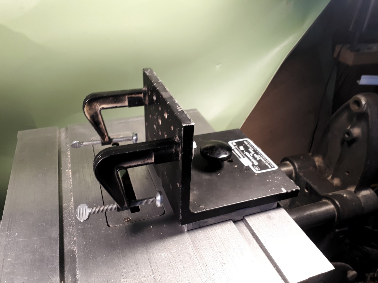

picture of the Craftsman Universal Jig, similar to the SS Tenon Master

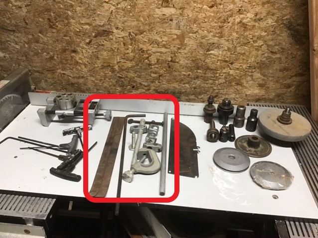

Re: A new owner of a shopsmith
#6
That cylindrical blox thingie in de box is a 1/2" router chuck.
Yes that blox flat thingie IS a planer blade height gauge.
HANG ON TO IT!!! They do not make em like that vintage any more.
Nice haul

Most of the parts in the red area below are not part of a Maxi Clamp set but the older Universal Hold Down set.
sksquX parts.jpg (99.78 KiB) Viewed 20487 times

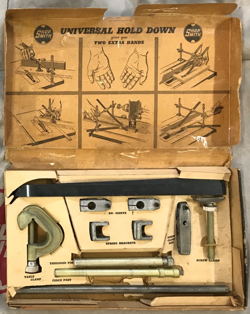

Below is a Universal Hold Down set from the Model 10 era. It changed for the Mark 5 to set screws and cap screws using a 5/32" Allen Wrench from the 1/8" one used on the set in the picture.

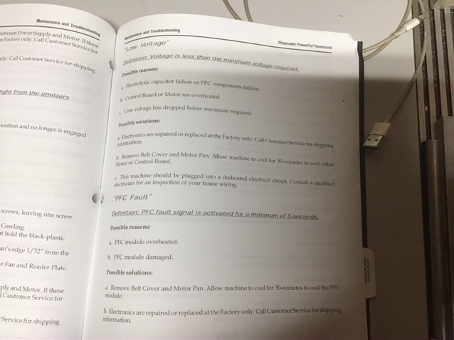

Does that manual have more PowerPro error codes? If yes, we are looking for an explanation of "LOW!" in another thread.
- David
Posts: 6584
DLB wrote:Does that manual have more PowerPro error codes? If yes, we are looking for an explanation of "LOW!" in another thread.
- David
Yes it does. I think there is confusion in the other thread. The OP of that thread says the machine quits and he gets a "Low" indication. He is tying it to his "problem" with RPM fluctuations.
The Low is actually Low Voltage on the display panel. It is mentioned in the manual with most of the other error messages we have seen over the years on the forum. Every time you turn off the Power Pro with the main switch on the head stock you get a Low Voltage error. The DC power supply output capacitors maintain enough voltage after the switch is turned off to power the electronics for a few seconds. The control panel stays functional until the voltage drops below the threshold and you get the error message and then the panel goes blank.

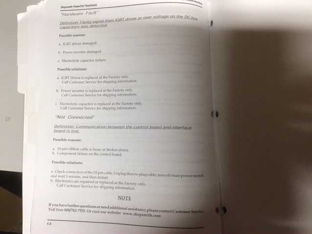

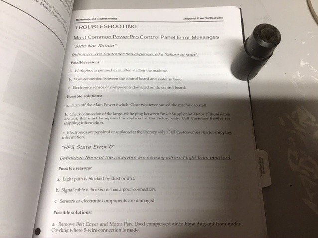

Hey David
This is what is in my booklet.
Posts: 6584
- David
Hey David
Same here.
