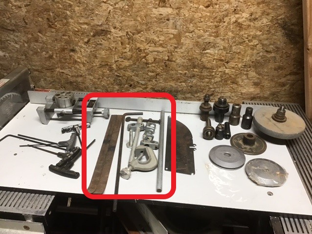

SkullsquadronX wrote:These are the things that came with the 1980 Mark V 500, except the lower saw guard. This one did come with the lower guard like the 1982 didn’t come with the upper guard. I’m still missing a piece of the 500 saw guard.
Something I know what they are a something have me baffled.
#1 - Saw guards missing the "L" bracket that connects the upper and lower, and the wire loop that goes on the front of the upper guard.
#2 -
#3 - extension table, shaper/drum sander fence, ?
#4 - wobble dado blade
#5 - drill guide or possibly a dowelling jig, T handle Allen keys, parts of a Maxi Clamp set, end plate for ?, shaper arbors, router chucks, grinding wheel on arbor, live,drive,dead lathe centers, face plate, saw blade stabilizers,

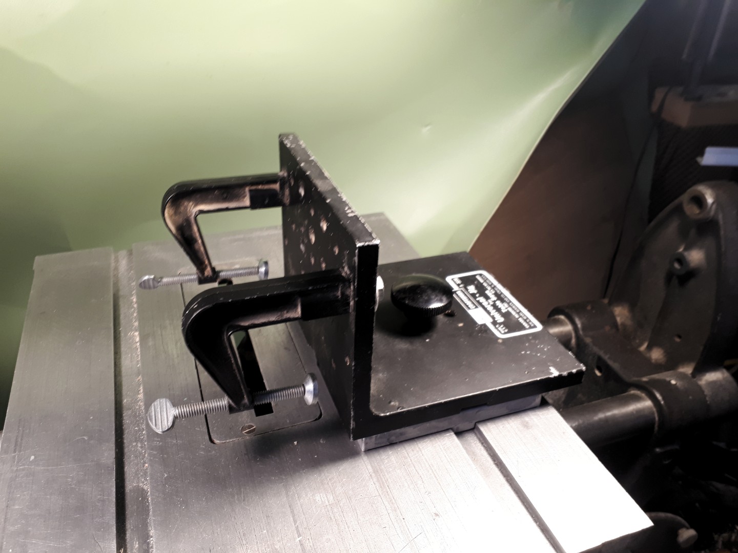

#6 - saw wrenches, clamp arms for a Craftsman Universal Jig http://vintagemachinery.org/pubs/detail.aspx?id=1426, an old type of lathe chuck, blade height setting tool for the SS planer, ???
#7 & 8 - sharpening guide.
picture of the Craftsman Universal Jig, similar to the SS Tenon Master

Thanks Ron the picture helps with the universal Jig. I had a feeling that some pieces of the Maxi clamp system but I could have been wrong.
The end plate, I’m loss on though it might go to the planer. Ok on the planer tools. I was loss on the sharpening guide.
Oh ya and that was a doweling jig it’s say so on it.

#6
That cylindrical blox thingie in de box is a 1/2" router chuck.
Yes that blox flat thingie IS a planer blade height gauge.
HANG ON TO IT!!! They do not make em like that vintage any more.
Nice haul

Most of the parts in the red area below are not part of a Maxi Clamp set but the older Universal Hold Down set.
sksquX parts.jpg (99.78 KiB) Viewed 20506 times

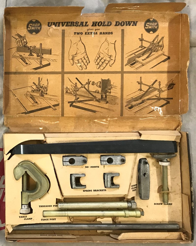

Below is a Universal Hold Down set from the Model 10 era. It changed for the Mark 5 to set screws and cap screws using a 5/32" Allen Wrench from the 1/8" one used on the set in the picture.
Universal Hold Down.jpg (229.15 KiB) Viewed 20506 times
As already said the item in the far left corner is a doweling jig just like one I have had for decades.
