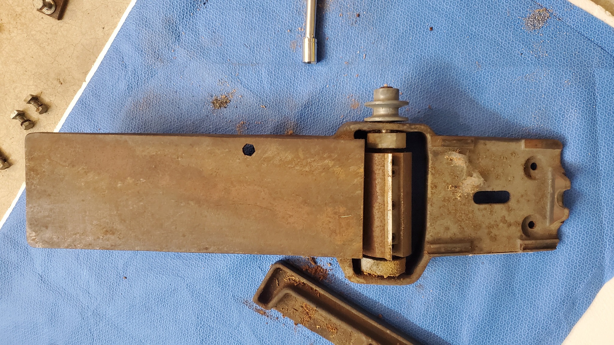

Got the jointer ready for some good cleaning.

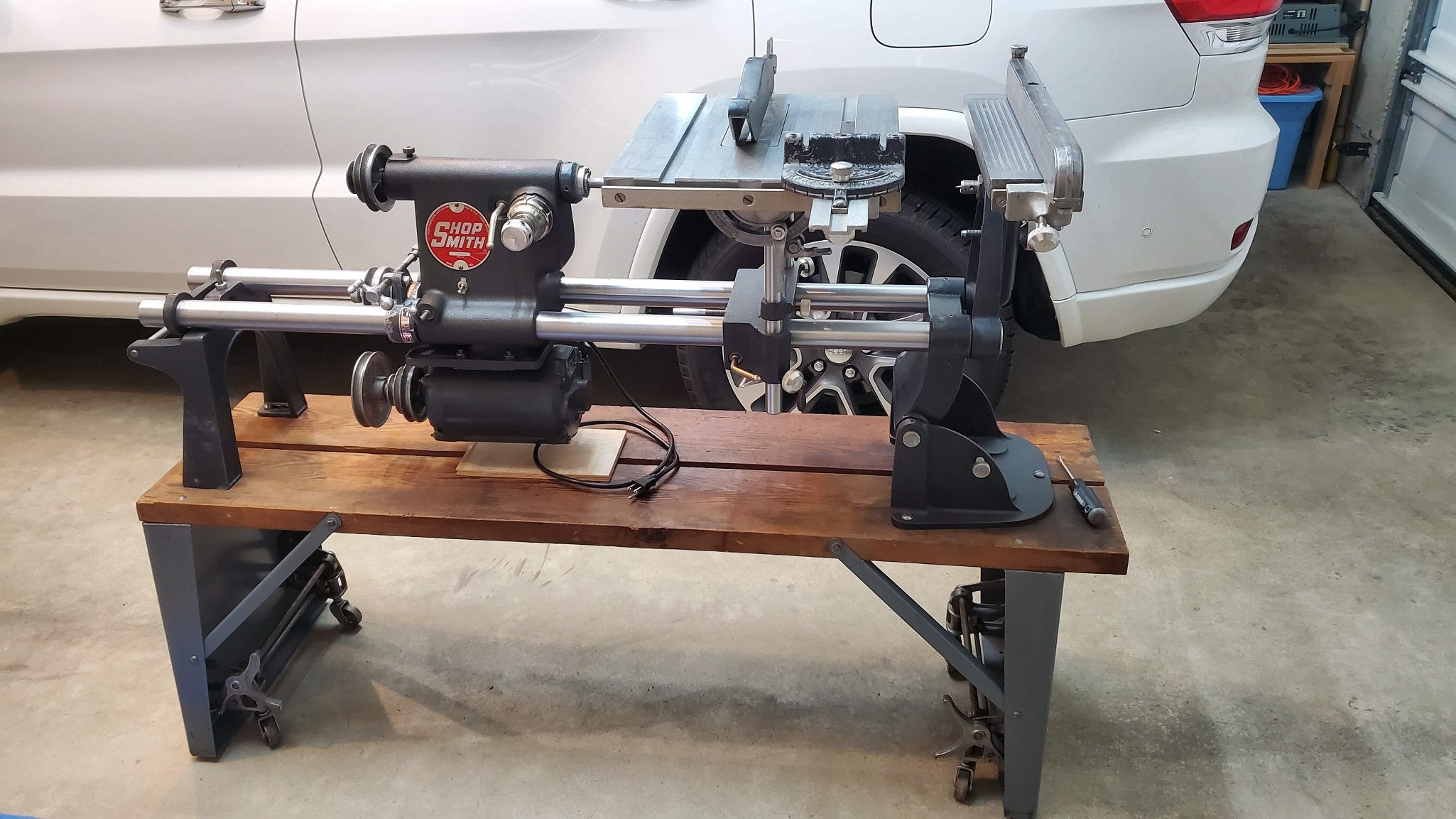

Update -
Installed the new on/off switch and fired up the motor! Runs good. I didn't notice anything excessive noise or vibration after the initial quick on-off. SS is mostly reassembled, but I still have some touch-up waxing to finish after removing some paint splatter and a large stain on the base plate.
All the new belts should be ready for pickup today and I will finally get to try out the SS! Hopefully the floating pulley on the speed changer function properly on the unevenly worn shaft.

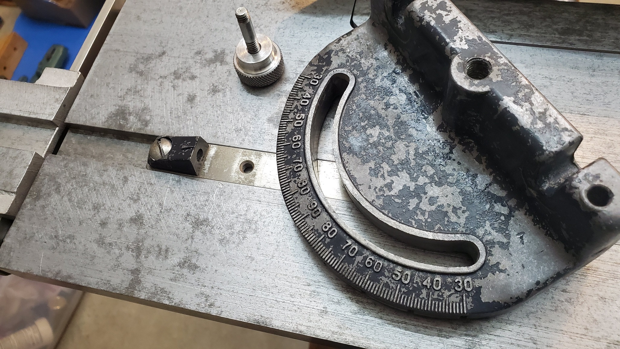

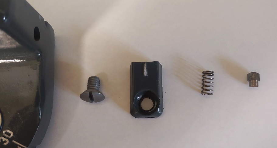

Parts question with photos - I tried looking for these, but didn't have any luck. SS product page is only useful if you know exactly what your looking for.
I'm missing the knob that locks the tail stock to the base plate (manual part #2337 Screw-Socket-Knurl). Is this something that I could still purchase?
Also missing the miter gauge indicator button and spring (manual part # A2312 and A2313).  Are these something that I could still purchase? May be from a new model? Update - Found the needed parts off a spare miter gauge!
Re: Craigslist find = New project 10ER
Tail stock retaining bolt not likely anywhere.(wish I had one)
Any bolt/knob will work unless you want to mount the table low. Only the table mount bracket will interfere.

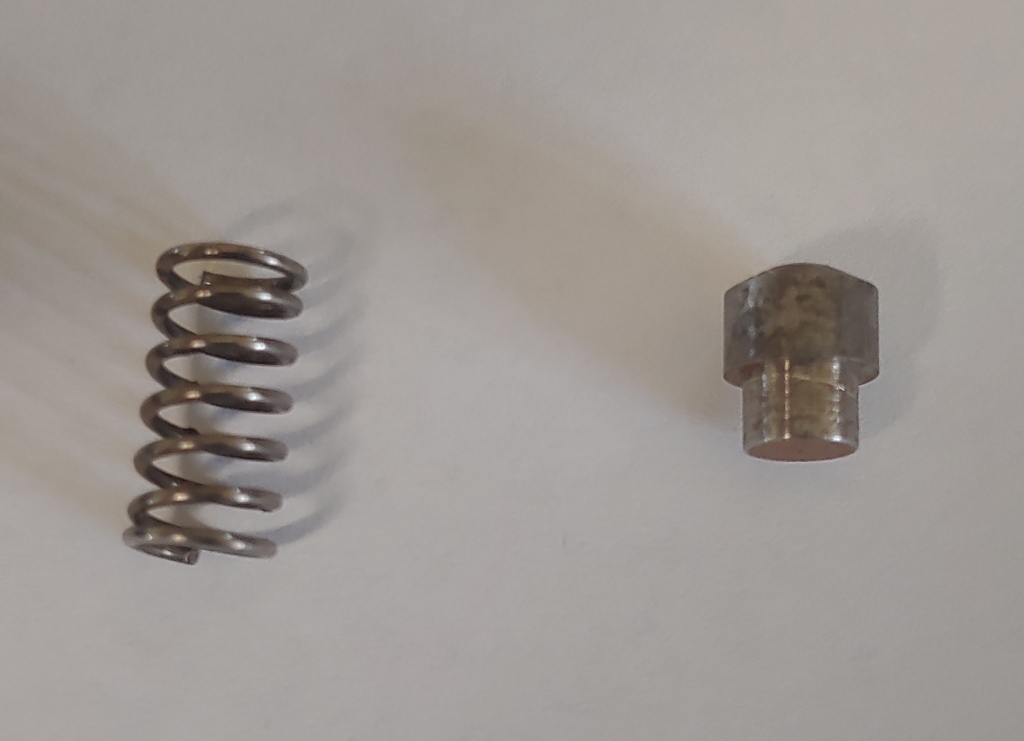

Missing spring and 'detent'? Welcome to the club! Somebody PLEASE take a pix of the detent pin.
The pointer is already shown in your pix.
I recommend a flat washer between the segment and the locking knob.
Also a thin shim washer between the bar and the segment at the clamp screw. The pivot already has a shoulder.

Essentially a dome (spherical) shape end or is it parabolic(bullet shape)?
Posts: 6585
It looks spherical to me.
