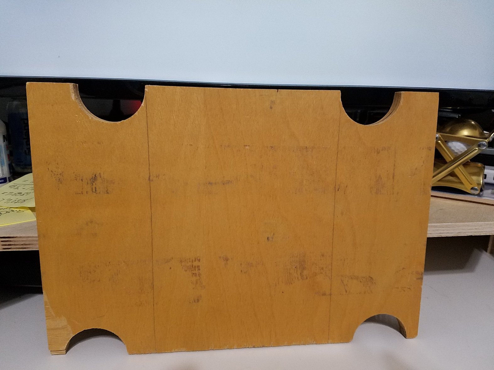

Don't operate the machine without the headrest being locked in place and properly centered (aligned). This is just another discussion about the tubes being "twisted" (someone else's words).
A long, long time ago, while working to resolve the perceived interchangeable extension table issue, I made a simple jig to help ensure that the Bench Tubes were properly positioned with respect to the Way Tubes. I guarantee that with this jig captured between the Ways and Bench Tubes at the left end of the machine - there is minimal if any movement.
Bench Tube Stabilizer and Alignment Jig
