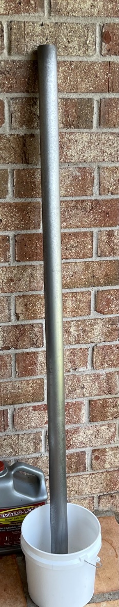

I’m working on trying to polish/wax the way tubes today...they’re not getting terribly shiny, I’m afraid.
- 436026B4-FB0A-4E33-B2DE-10B3A1DB9164.jpeg (167.37 KiB) Viewed 4595 times

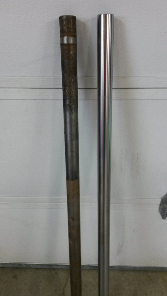

See mickyd's post in the following link. it's the fourth one down.
viewtopic.php?p=32230
Although it was for Mark 5 bench and way tubes the idea is the same. For polishing tubes I use my Mark 7 with a similar expansion plug and a set of rollers on an extension table instead of the drill setup. Below is a before and after picture of a pair of way tubes for one of my restorations
_ _
Not the worst pair I have had and not the best either.
