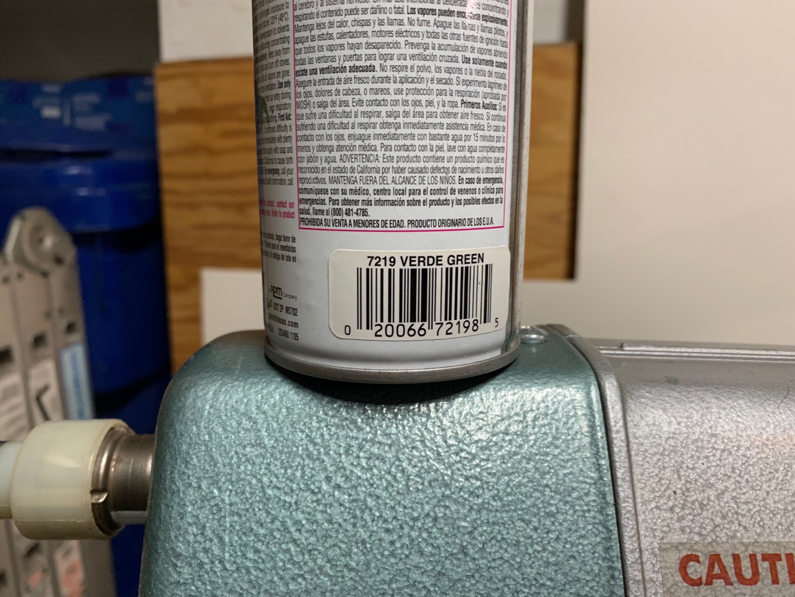

I remembered the question you asked me while we were talking about something else, it was about the paint. Below is what I used.
Rust-Oleum “Hammered”
Color: Verde Green (or translated to English, Green Green)
Marc Jones
Re: Jointer Cleanup and Repair
Unfortunately Verge Green is IIRC no longer made by rustoleum.
