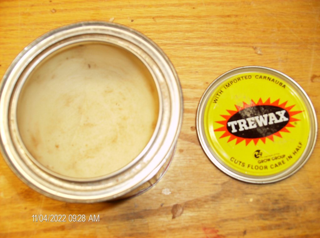

It seems to me that Johnson's wax isn't worth the cost or hassle of keeping it in usable condition.
I've been using a can of Trewax since the 1980s, and after 30+ years of sitting around, sometimes in temperatures well below freezing in Winter and around 100 degrees in Summer, it still retains its original texture and condition. If Johnson's wax can't do that, you can simply replace it with Trewax from your local Ace Hardware.
This is what it looks like after 30+ years.

Gary,
Good to know. Yeah, I have never had an issue (in the past) with JPW. I am still using a couple of cans that I bought many, many years ago and they are fine. What I was discussing on this thread was I bought a new can and in shipment (or before shipment) it separated and became an applesauce like mess. The company replaced it for free with a new can that was perfect and still in suspension. I was trying to decide on the best method to remake the emulsion for what is left in the compromised can so it doesn't go to waste. Thanks. In other 20 years or so when I exhaust my JPW inventory, I will be sure to pickup a can of Trewax.
