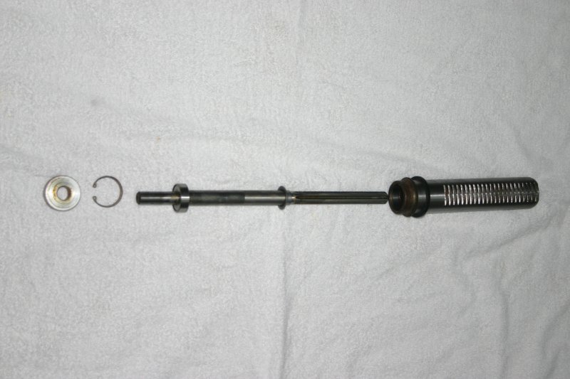

Picked up five new bearings today. $45.
Many, many thanks for the photos and info on the drive shaft. As for the other shafts...
Battery: I think one goes on the very back end of the shaft. The other goes somewhere before the magnet, but I don't think it butts up against anything.
Quill: I don't think this bearing butts up against anything either.
Have hairdryer. No dry ice, but I do own a freezer.
Again, lots of good comments. Wouldn't mind hearing a word from Bill.

Battery? Magnet? Bill Please help him!
OK:)edward wrote:Motor! I meant motor!

edward wrote:Vital therapy?! I am going to need vital therapy once I'm done with this thing.
Quill definately has a shoulder that it butts up against.
[ATTACH]3491[/ATTACH]
- Img_4909mod.jpg (63.66 KiB) Viewed 3084 times
