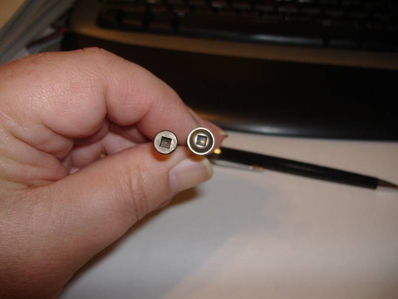

Hi,
OK let's start with the Kreg type screws, they have a wider bearing area, the difference is small but as a personal preference I like the Kreg screws better.
Here is a picture:
[ATTACH]3907[/ATTACH]
I should point out that they also sell Kreg screw so I can still get them from them. Of the three big box stores here in my area only one cares the Kreg screws and only a limited selection.
