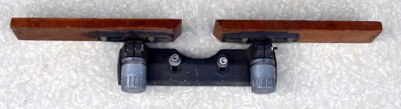

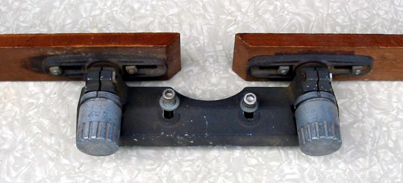

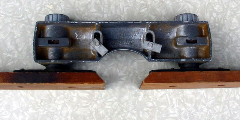

shaper fence for Mark VII
Post by riddler »
I just picked up the elusive Mark VII (elusive to me in Baltimore that is:) ) It looks as if the SPT's and table inserts from the Mark V are all compatible but that the shaper fence is insufficiently long. Did Shopsmith make a shaper fence for the Mark VII , and if so, does anyone have a spare they are willing to sell? Any info is appreciated. I love this site--there is a lot of enthusiasm and knowledge to tap into.
SDSSmith
Posts: 1940
Location: San Diego, CA
Post by SDSSmith »
riddler wrote:I just picked up the elusive Mark VII (elusive to me in Baltimore that is:) ) It looks as if the SPT's and table inserts from the Mark V are all compatible but that the shaper fence is insufficiently long. Did Shopsmith make a shaper fence for the Mark VII , and if so, does anyone have a spare they are willing to sell? Any info is appreciated. I love this site--there is a lot of enthusiasm and knowledge to tap into.
There was a shaper fence that was unique to the Mark VII. I had one but have since let it go. I will see if I still have a picture of it.
Rob in San Diego
SDSSmith
Posts: 1940
Post by SDSSmith »
Here are pics of the Mark VII fence I had. As I recall it is in Pennsylvania now.:)[ATTACH]12770[/ATTACH]
[ATTACH]12771[/ATTACH]
[ATTACH]12772[/ATTACH]
