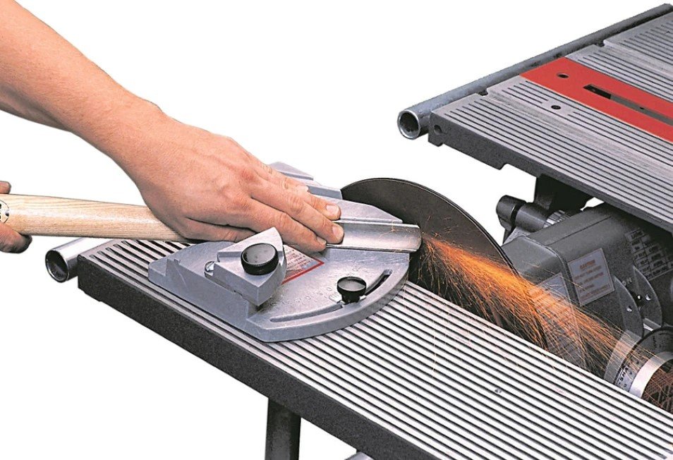

The Sharpening Guide is an easier guide to use for sharpening Lathe Chisels than the Strip Sander Sharpener. When using the Sharpening Guide with the 12" Sanding Disk (shown below) use caution not to overheat the Lathe Chisel tip. Make sure you are using it in a clear area as it throws out a lot of sparks.
_
Lathe Chisel Sharpening Guide - SS.jpg (137 KiB) Viewed 1164 times
In the Shopsmith picture above it is mounted to the Extension Table which is an optional way to mount it.

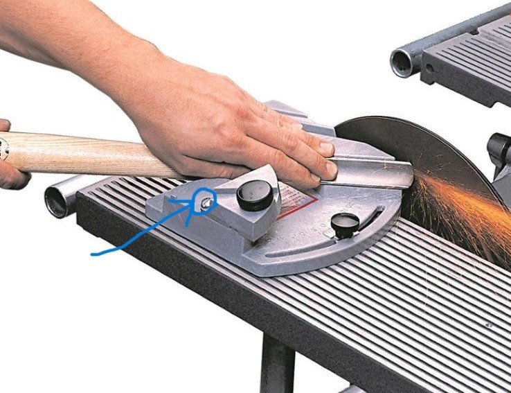

The first Sharpening Guide I purchased came in the original box and looked like it had never been used.
It also had the template to mount it to the extension table. :cool:
I found that the screw provided for the angled pivot point had quite a bit of slop/play in it.
I have some bushings I will install in them and use a shoulder bolt to replace the screw pointed out it the picture.

GetterDone,
The screw you pointed out in the picture is a pivot point and should not be too tight. This allows you to move the Roundnose Chisel back and forth for sharpening.

The previous picture shows it mounted on the Extension Table. Note the direction the Sanding Disk is turning relative to the Lathe Chisel. This has an advantage over the Sharpening Guide mounted on the Main Table which has the Lathe Chisel facing the opposite direction of the rotation of the Sanding Disk. It is relatively easy to gouge the sandpaper with the Sanding Disk rotating into the "point" of the lathe Chisel sharpening it on the Main Table unless you have a reversing motor like the Power Pro Headstock. Kind of the same reason you run the Strip Sander in reverse for Lathe Chisel Sharpening. It can be used on the Main Table without "gouging" the sandpaper with light pressure pushing the chisel in to sharpen. It should be done with light pressure which helps reduce heat buildup too.
Mounting the Sharpening Guide on the Extension Table requires drilling holes in the Table's top to mount it. On the Main Table it attaches in the Miter slot.
Having the Sharpening Guide mounted on the Extension Table has it in only one position relative to the Sanding Disk with the only adjustment being the height up or down of the Extension Table. On the Main Table you not only have the Table height adjustment but can move the Sharpening Guide back and forth in the Miter Slot.
Using the Extension Table, you can have the Sharpening Guide ready for quick sharpening jobs in the middle of a turning project by just sliding the Headstock over (for drive and Tailstock mounted turnings) or if doing bowl type turning the Headstock can be placed next to the Extension Table during turning. Using the main Table means removing the item being turned and the Lathe Tool Rest followed by mounting the Sanding Disk and inserting the Main Table. A much more involved process for Chisel Sharpening.
These advantages/disadvantages are in no particular order. They were just as I thought of them and may not list them all. Either way you use the Sharpening Guide it will give you nice sharp ready to use Lathe Chisels.

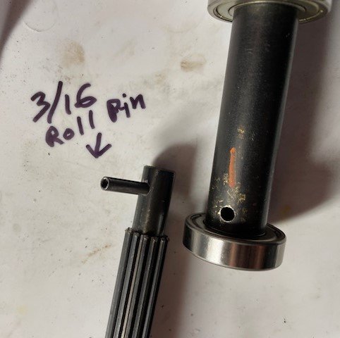

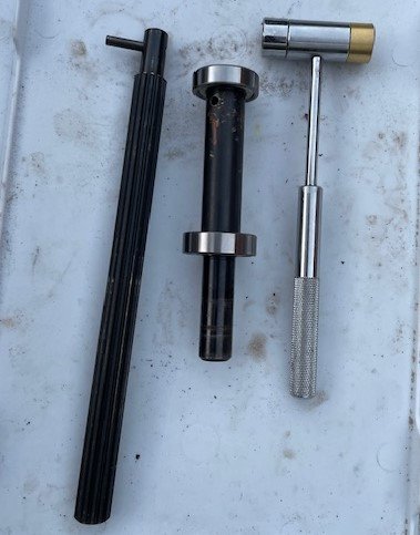

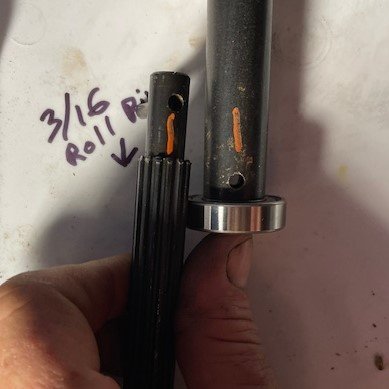

I got the new bearings on the Quill shaft and got the 2-piece shaft back together.
I marked the shaft and put it back in the same orientation.

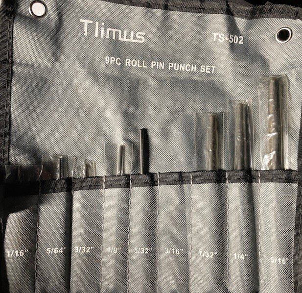

I got this set of Roll pin punches from Amazon.
