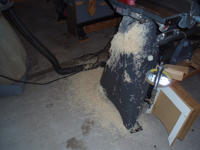

Earlier I spent some time trying to improve on the saw dust collection system that I use. I thought that I had made some real inroads and then this happened! Guess I still have a bit of work to do.
dusty wrote:Earlier I spent some time trying to improve on the saw dust collection system that I use. I thought that I had made some real inroads and then this happened! Guess I still have a bit of work to do.
Yep! the shop gremlins relocated to the jointer!:D

dusty wrote:I thought that I had made some real inroads and then this happened!
Just let the chips pile up under the infeed table. That HELPED mine. :D
beeg wrote:Just let the chips pile up under the infeed table. That HELPED mine. :D
It surprises me that 'debris' collection works as well as it does on the jointer considering the 'chips' are being flung forward AWAY from the 'chute'. Perhaps as Beeg said, let the infeed side fill up. That would cause the chips to leave the blades later(toward the chute).

dusty wrote: Guess I still have a bit of work to do.
Wow. I'd never thought of using my jointer to shred Parmesan cheese. I bet you have to do it on a cool day, eh?
