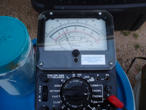

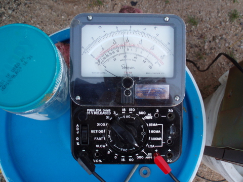

I may be the only one who wondered whether or not something had to be added to increase the conductivity of the water but I wonder no more.
After cleaning up my tin snips and a couple of heavy duty swivel wheels, I dumped the solution and reestablished the setup with fresh water. There is some residual soda in the water as evidenced by a skim of bubbles but it is close enough to "clean water" for this experiment.
[ATTACH]8646[/ATTACH] [ATTACH]8647[/ATTACH]
One photo shows the current flow (about 75 milliamps) in water without soda.
The other shows the current flow (about 2.8 amps) in the same water with soda added.
- Water Only...with some Residual Soda....jpg (102.18 KiB) Viewed 7746 times
- Added Soda...to water with Some Residual Soda....jpg (111.91 KiB) Viewed 7746 times

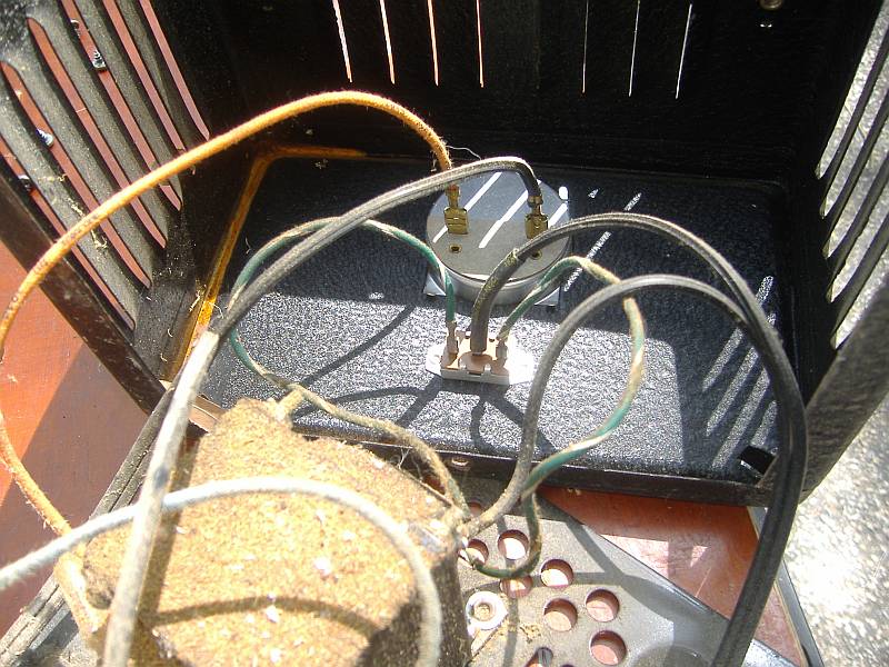

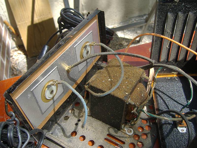

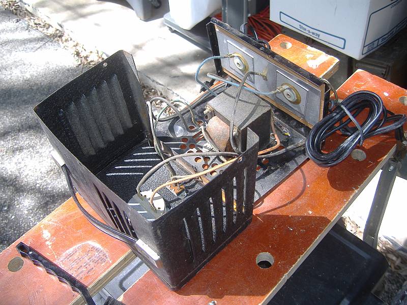

Hi,
Opened the battery charger this afternoon, looks like I need to store it better as it had quite a bit of dust inside. So it needed a bit of cleaning and figured I might as well fix the dented bottom while it was apart...
Age wise the nearest I can figure is that I got it new in 1971 at a Western gas station in Wausaw WI.
Now the pictures:
[ATTACH]8649[/ATTACH]
[ATTACH]8650[/ATTACH]
[ATTACH]8651[/ATTACH]
Now the pictures:

- Posts: 35430
Selenium diodes! Been a while since I have seen those!
