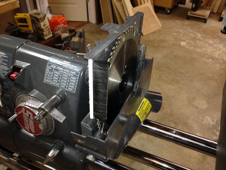

I've been using this dust deflector for about 2 weeks. It is made from a door sweep from the borg. This one had a plastic holder that was designed to be screwed to the bottom of the door. The brush (which has a metal spine) slides into the plastic holder. I cut off about a 4 inch section of holder/brush. Be sure to crimp the end of the metal spine and add a drop of CYA glue to prevent the bristles from coming out of the ends of the cut spine. I then cut away all of the holder except the part that accepts the brush's metal slide and attached it with heavy duty double stick tape to the front lip of the lower saw guard. The photo should be self explanatory.

Its best feature is that it does not interfere with the tilting table; the table simply pushes the bristles down. It also adapts to different widths of the lower saw guard, although this brush isn't long enough when the guard is fully open. An even longer brush would be ideal but this still works very well.
Edit: I have since abandoned this brush-type deflector and attached an accordion-style solid plastic deflector as shown in subsequent posts.

Yes, both based on your prior reports in this thread and my own observations. Most of the dust escapes from the gap above and to the right (as observed from the operator) of that front lip of the lower saw guard. One day when I was cutting a lot of deep dados it actually piled up there until it formed it's own clog/barrier. To a lesser degree dust escapes between the lower saw guard and the tie bar protector. Do you disagree?dusty wrote:Have you studied the saw guard while in operation to determine where the dust is actually escaping from? I think you might be surprised.

The brush in the photo can be slid upwards, slightly, without interfering with operations. I do not claim it is 100% effective, however, it is a significant improvement for me and better than the solid deflector I had been experimenting with and which needed to be removed to make a bevel cut with the tilted table. A brush with longer and denser bristles would be better still.
No, I do not disagree.

The issue, which I am sure you are aware of, is that that gap through which most of the dust escapes does not remain static. As one raises or lowers the table, it changes height. That's a relatively easy fix. In addition --and this is the complicated bit -- as the table tilts (and you advance the quill to keep the blade centered in the table insert) the gap changes width AND shape. By the time you have fully tilted the table to 45 degrees and advanced the quill to compensate for the tilt, the rotation of the tie bar guard forces one to close the lower saw guard almost to its minimum and the tilting of the table nearly closes the gap and cuts across the top of the gap at at 45 degree angle. Accordingly, the current design is probably about the best that can be done while maintaining the ability to make bevel cuts and dados (which requires setting the lower guard to wider settings) IF the entire guard is made out of a rigid material. Anything put into that gap must be flexible enough to conform to these changes in shape if the table saw is going to be able to make dado and bevels.
