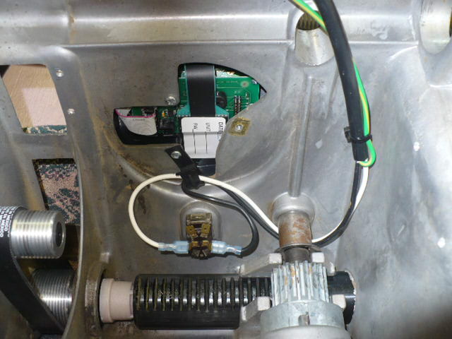

Hey All,
Have been working on my upgrade off and on for a couple of days. I have a type B headstock. I am at the point in which I am ready to install the power supply. I have reviewed the video that came with the upgrade and reviewed the online install posted by (I can't remember the name and the paper is out in the shop). The printed instructions have me threading the power cord leads to the switch over the quill lock, through a cord retainer attached to the back of te control panel and connecting to the switch. I have it attached that way but it leaves much less of the pig tail than indicated everywhere but the printed instructions. In fact image 33b shows the connection routing and 34 shows the end of the pig tail almost reaches the outside edge of the bottom of the casting. I am attaching a couple of pics one of my current state of build and one of the instructions. Should I leave it like the printed instuctions or not rout the cord over the quill lock? Also, the tab on the back of my switch that the black power cord attches to is slightly loose. Should I go ahead and replace the switch now or will it be OK? Don't like the plastic switch SS sent but I can get a better one at a local eletrical supply tomorrow. Thanks in advance for any assistance....

claimdude wrote:Hey All,
FWIW Earlier version of install manual did NOT route the line cord over the quill. ???
Make sure your 'non-plastic' switch has a higher electrical rating than the 'plastic' one.

I don't know if the the earlier version of the manual had different cord routing.JPG40504 wrote:FWIW Earlier version of install manual did NOT route the line cord over the quill. ???
On the switch issue. The maunal says if you have a type B or C headstock the new switch is not needed. Should I still be concerened about the power rating of my existing switch?
I'll try SS in a little while and see if they are open and get some advice.
