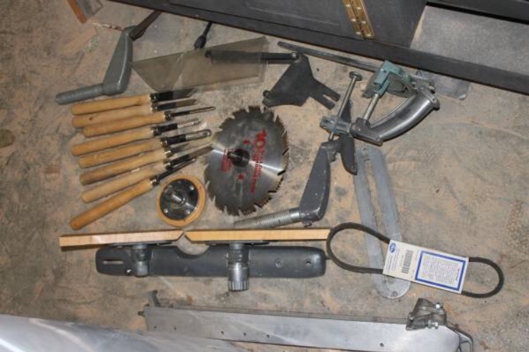

Here’s some pics of it. I have to figure out how to resize the others so they fit...
- 588CD24B-79D4-4616-89D1-4F0A5E337C11.jpeg (39.3 KiB) Viewed 14004 times
- 72B692F4-B35E-4AD9-807C-03A5E559C8BC.jpeg (121.34 KiB) Viewed 14004 times
- 601015A6-4802-4207-B76E-8065F988742C.jpeg (192.37 KiB) Viewed 14004 times
- 6258C5F9-35A2-4CEE-A132-8339EFA47A88.jpeg (77.43 KiB) Viewed 14004 times
Re: Which ShopSmith model do you use in your shop
An interesting 'mix'. Greenie miter gauge and a Mark 5 shaper fence. I know not what the saw guard fits.
Do determine the cause of the noises before running it much.
Pay close attention to the speed cam etc..
I do not 'see' the vac housing. I also notice the addition of a hinge to the front(?) cover.
Do perform PM first.
Good Luck with your good fortune. Treat er as a fine heirloom so you wife will have been a prophet(That's good right?).

I haven’t messed with the attachments much. I didn’t see the blade guard with what he had but he saved my number in case he found anything else he thinks might go with it. It needed a good cleaning before I did anything else (pretty sure that’s why he thought it was a V instead of a VII) so I went from that to taking apart the head to find the noise.
I think I know what happened. The slight “rumble” it had that he thought was a bearing was a misalignment on the shieve between the pulley shaft and pork chop of the speed control. When he went to adjust the speed to show me it worked, the shieve popped off and made the sound like a rock bouncing in a wheel well.
The inside of the housing was pretty well caked in sawdust and there was almost no grease left on the pork chop. Have yet to see anything that recommends what kind of grease to use, just to make sure it is “well lubricated” every 10 hours.
