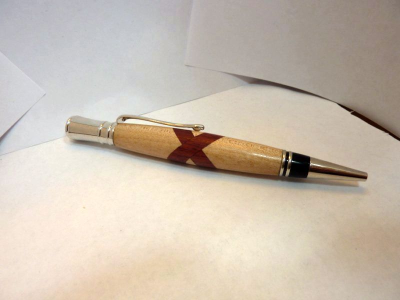

I do use a tiny bit of superglue when assembling the clip end (I use a toothpick to apply a touch of superglue to the clip, where it looks like a washer). I don't bother using superglue putting the clip finial in, or the nib, or the transmission. Maybe I misunderstood your post on assembling the hardware, though.
A couple more sources: Craft Supplies USA (http://www.woodturnerscatalog.com/) is also a good supplier, though I prefer Penn State's catalog; Woodcraft (especially if there's one local to you). I hear Rockler also has pen making supplies, so if you've got one local to you, by all means visit them.
Lastly: For beginning penturners, I suggest one-tube pen kits (see example attached). They may be slightly more expensive than the slimline kits, but they're much easier to turn! (Only need to match up two bushing ends, not 4)
For all who are thinking of jumping in: Just do it! You'll have a blast. Everyone sort of comes up with their own "what works for them."
Again, thanks for taking the time & effort to put together a great tutorial!

I don't use glue on the transmissions but I do glue the clip to keep it from working loose and spinning. It will leave a groove on the wood if it does so. I had one batch of kits that the lower tip fit really loosely so I got into the habit of just using a little glue there as well. Better safe than sorry in my opinion. As to worrying about removal of the parts it is like an airplane backing up.;) I just chunk it and start from scratch.
Nice looking pen hdtran. I really like the inlay.

Definitely thanks Mark. I learned a lesson about sanding the brass tubes and have now bumped a 4 jaw chuck up on my wish list.
I agree with hdtran regarding "Just Do It! You'll have a blast!" get started and figure out what works best with the resources you have. Although I do recommend some of the really inexpensive fun line slimline kits that come in packs of 5. at less than 2 bucks a hit, it's much easier to stomach a goof.
hdtran,
Nice looking pen.
Inlay or segmented? Species would also be nice to know.

Segmented, as opposed to inlay. Purpleheart (it doesn't look like purpleheart because of artificial lighting and camera operator incompetence) on maple.
Cut two slices of purpleheart of equal thickness at a bias; sand smooth; cut a maple blank on the bias; sand smooth, glue in one of the slices of purpleheart, clamp & dry; cut the opposite bias and remove the correct thickness; insert the second slice, glue, clamp, & dry.
Saw cuts were done on the Shopsmith bandsaw, cleaned up with the Shopsmith disc sander (see a theme here?) and glued using epoxy. If you've made a tablesaw sled with appropriate clamps and you have a dado blade, you could also do it by dado-ing a slit in the maple, insert the segment, glue, dry, then, dado-ing a second slit, etc.
I did 5-7 layers of boiled linseed oil/superglue on the finish (check the late Russ Fairfield's website for the finish, and many youtube videos). If you're going to do the superglue finish, wear proper protective equipment (face shield, gloves, mask, and have dust collector sucking fumes away).

Look more like this?:)
