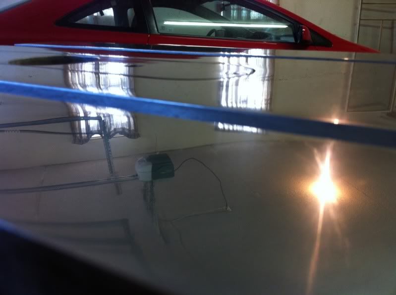

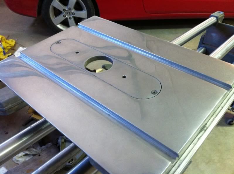

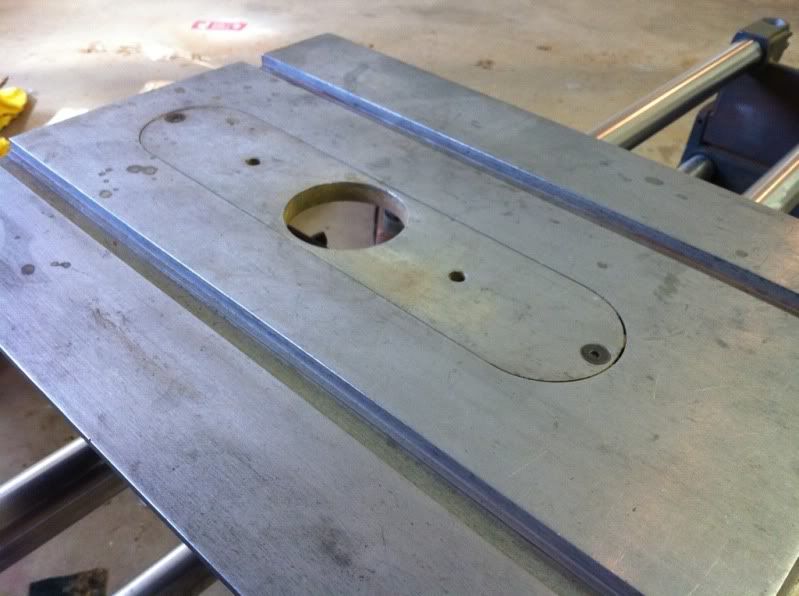

gat_76 wrote:since i have never done anything like this, i really was not sure how it was going to turn out.
here are the pics after i re-did it, searching for the "mirror"... overkill, but i had to, it was fun
begenning
finished result
this morning
done

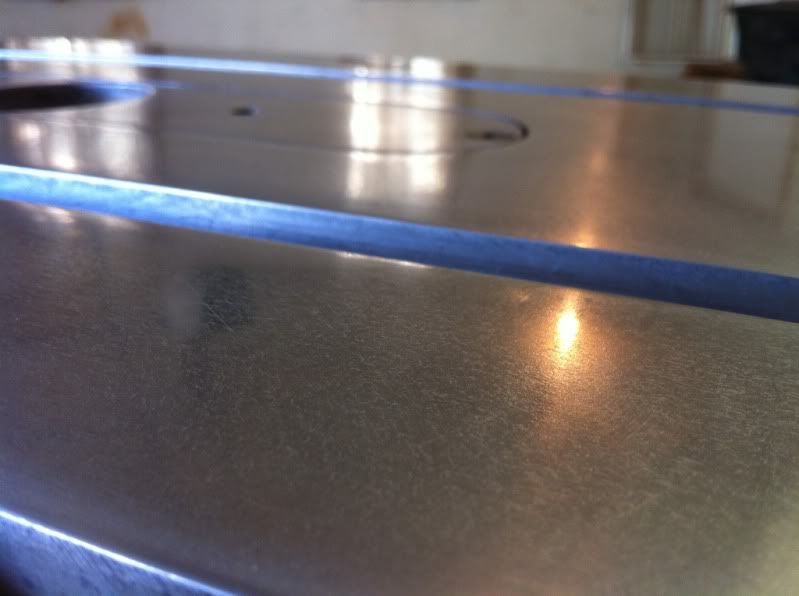

well, it was dang hard. soooooooo easy to mess up when it is getting that smooth. and of course, i had a lot of patience but not enough to get it perfect.
it will be scratched up the first time i use the table saw, but ohwell. it felt good!!!
now i have to quit playing and move on to more important steps in the restoration!!!!
You can't use it now... It needs to be put up on a pedistal from all the work. It wouldn't be right to defile it. Find another one cheap and us it. Truthfully it is awesome... looks better than it did new I bet.

bigeddy wrote:You can't use it now... It needs to be put up on a pedistal from all the work. It wouldn't be right to defile it. Find another one cheap and us it. Truthfully it is awesome... looks better than it did new I bet.
Lol. Thanks man!
... I'd do it to another one if someone wanted to buy it (thought just occurrd to me).

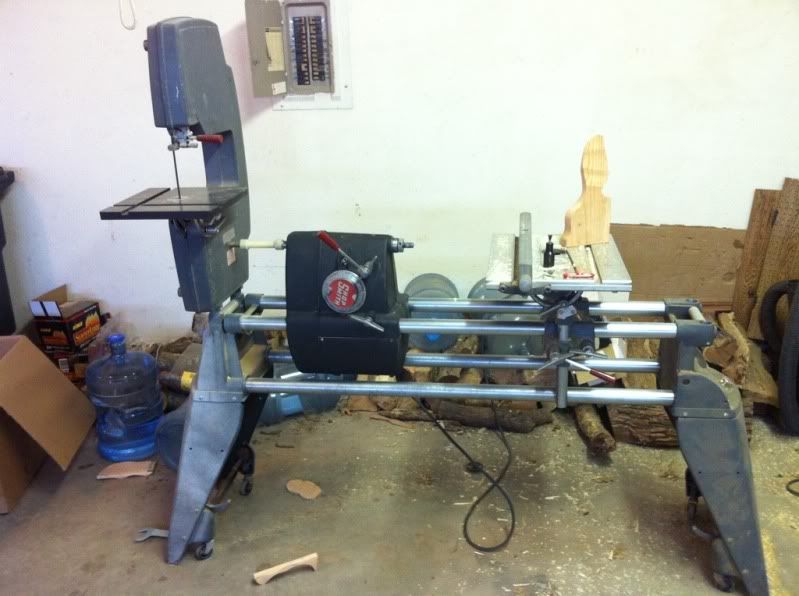

well, im done for now. tomorrow i will be cutting.
I got my last part in today. she sounds beautiful. when i first got here, she sounded like a bomb, it was scary. iv sawed, drilled, routed, and bandsawed so far. all seems well.

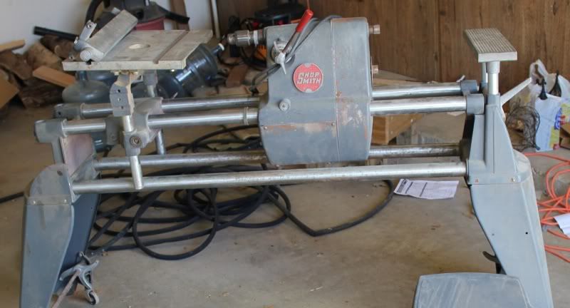

here is the when i got it.
and now
I know some of you guys might be disappointed that i didn't go all the way. but i did my best on all the moving parts. purrs like a kittin.
there is the tiniest bit of rust inside of the legs (much to my surprise), so they will be fine.
and when i was getting the paint, the black, rubberized undercoating just called out my name. now that its done, i like it.
Dr says i only have about 40-50 more years to live

gat_76 wrote:and now
Now that's different:cool: Never thought of undercoating. When you get a chance get a closer picture of the paint job will ya?

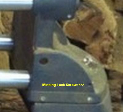

If you intend to use it in raised drill press mode, get a lock screw to keep it from flopping back down. The screw has a tapered end that wedges in the side of the oversized dimple in the end casting.
[ATTACH]12738[/ATTACH]
The dimple can also be seen. It is the 'silver spot'.
Is it by any chance resting on the casting in this pix?
lock screw.jpg (14.81 KiB) Viewed 2637 times

JPG40504 wrote:If you intend to use it in raised drill press mode, get a lock screw to keep it from flopping back down. The screw has a tapered end that wedges in the side of the oversized dimple in the end casting.
ahhhhhhhh, thanks. i will do that promptly.
anyone happen to know the thread size for the lock screw?
edit: i read it too fast. you didnt say casters.... lol
no, it is not sitting on the casting. the big black spot looks like a hole in the low resolution, but it is the end of a rod.
