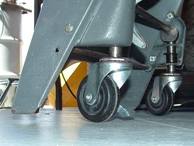

Okay, so being the cheap bastardo that I am, (plus they were back-ordered on the ones at SS), I bought a set of casters on Fleabay. Finally got them the other day, they're okay, but have kind of a gummy wheel, which is nice on a smooth CLEAN floor.
I do metal work in my shop as well and these would be picking up every piece of swarf and stay embedded in the tire.
SO, I put them in a cart I use in my house which has a nice tile floor throughout.
The casters that were on the cart were also 3", some very nice hard rubber with bearings and wheel locks.
They had the correct 7/16ths stems, so in they went on to the Shopsmith.
Here's the trick on the spacing of the holes. The holes need to be 1 3/8" higher than whats already there. Easy PEasy etc...............
I don't know what spec Shopsmiths template is, but with the 1 3/8, I've got a nice half inch clearance in the full up position.
See the pic.
Oh, and Holy Crap! this now rolls Sooooo easy, what a major improvement!
