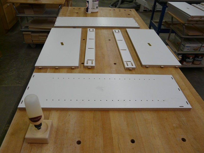

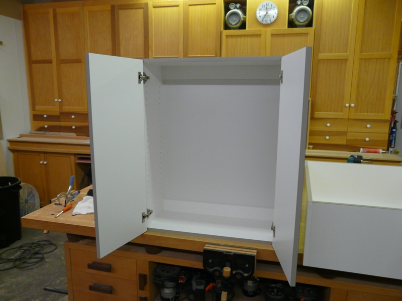

Dusty those are the European concealed hinges. They take a 35MM or 1 3/8" recessed hole 5MM from the edge of the door. I have a machine that drills and inserts them but it is very easy to do with the Shopsmith in drill press mode. It is actually a 2 piece hinge and the plates that attach them to the cabinet are surface mounted.

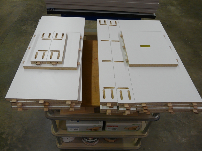

MB,
Thank you very much for the clarification on assembly. So in this photo you would assemble the "box" using glue, Festool domino's (biscuits), face screws and pocket holes? Then it is clamped together? Also I noticed that you just have bar clamps holding it together. Do you not need to use some type of corner brace or jig to keep it all squared up? Thanks again for answering all of my dumb questions but at some point I want to build some cabinets and boxes etc. and this post is enormously helpful.
