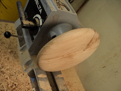

This is Garry oak with a knot. The method works. And as I have said before, I think that this is a safer way for a beginner to be doing this type of turning. I won't be arguing this with anyone, It's just my humble opinion. The second photo is "off the chisel", no tear outs no catches no drama. Just boring easy turning and just a little sanding left to do.
Paul M
Thanks Paul! I would have been an unsuccessful 'devil's advocate had you not come to Mike's aid! I hope there are other folks with different input as well.
I can imagine what that knot would do at a shallower angle.
I gotta think oak be less likely to act like the poplar though!

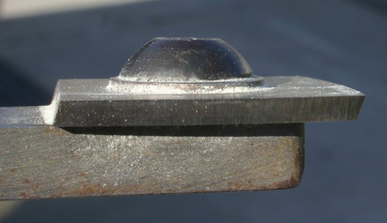

The problem with all the tear out and chatter I was getting appeared to be due to the scrapers sharpness, bevel angle, and shape. The front face of the scraper (relief bevel) was 85˚, dull, and square. Researching this sharpening article on the San Diego Woodturners website indicated that a scraper should be about at 70˚ - 80˚. So I took the liberty on this 'borrowed' chisel to put the edge at 75˚ (so do I own it yet Rob??:D ). In addition, I put a slight curve to the face when viewed from the top as recommended by one of their mentors I spoke with this week. (how about now Rob??:D ). Here's what it now looks like.

I was able to develop that slight burr in the top surface that they talk about but it wasn't a pronounced as I thought it would be. My fingernail would catch on it as I ran it across but I couldn't really see it. I also never got that "fireball" appearance on the edge as I ground it which as I understand comes from a nice burr when it forms. Also, a video I had seen said that when a good burr forms, the sparks will wrap around the entire grinding wheel circumference. Didn't get that either. Who knows!! Not enough experience yet. I DO know however that the scraper cut MUCH better than before. Insignificant tearout and absolutely no chatter. Used the same slowest speed setting on the Mark 5.

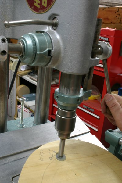

Shipwright reminded me that I had better put the leg hole counterbores on the backside before I completed the doomed seat top. Duh...good thing he reminded me. Used the ER10 on the speed changed on the slowest setting and a 1" forstner bit with the table set a 17˚ to bore the three holes, 120˚ apart.
[ATTACH]11122[/ATTACH]

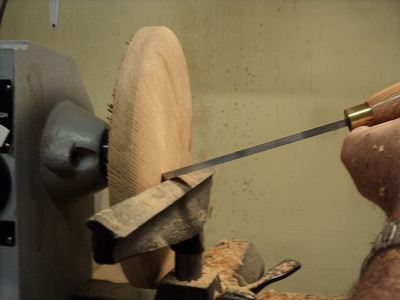

Once that was completed, I remounted the stock on the faceplate and worked on the face. Here's how it looked with the newly sharpened and profiled scraper. I experimented with different angles of attack and felt that it was best with the handle up at about 20˚, cutting just below the centerline.
[ATTACH]11123[/ATTACH]

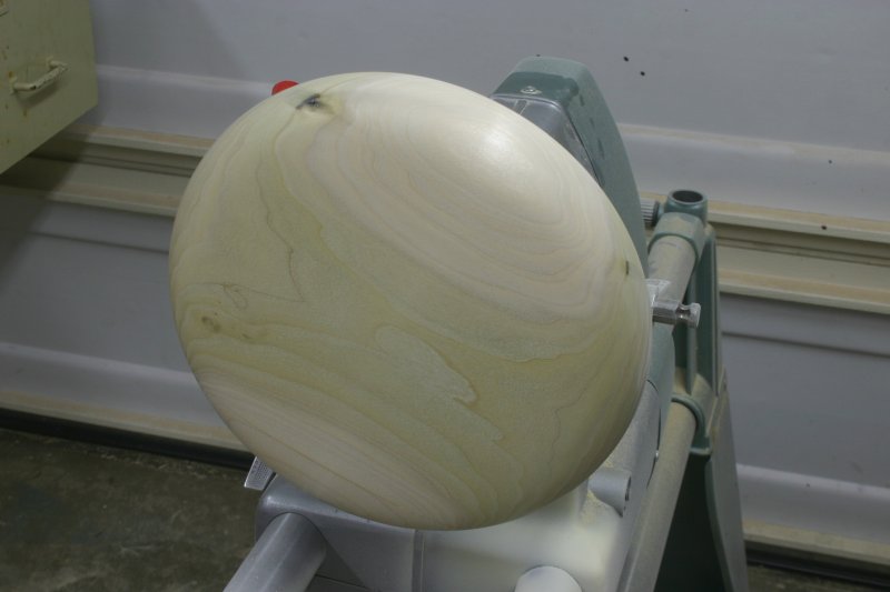

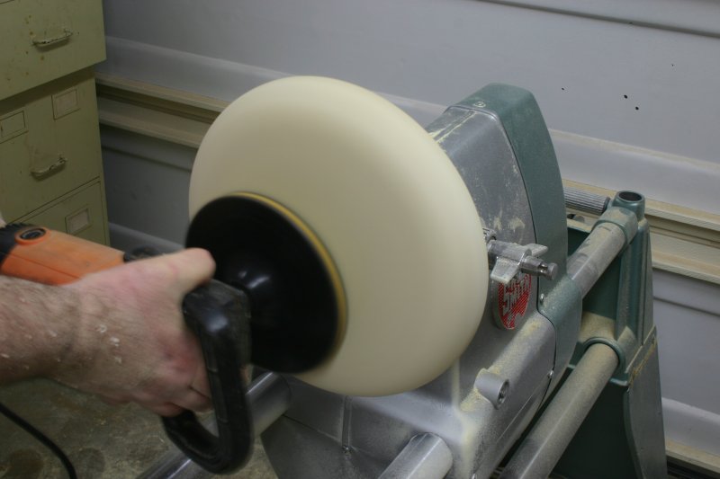

I continued on until I got the mushroom shaped domed profile I was looking for, then I used my angle grinder and progressively sanded from 60 up through the range to 400 grit.
[ATTACH]11124[/ATTACH]
Got the poplar to the point of shining!!! Real happy with how it came out. I think the grain is going to look real nice when I get some color on it.

Oh, and p.s., I was able to easily scrape around the edge radius without getting any tearout. That was an area that I was told could have been a concern when using the scraper.

Oh, and p.s., I was able to easily scrape around the edge radius without getting any tearout. That was an area the I was told could have been a concern when using the scraper.

Funny you asked! Before I started sanding, I put on my cheapo white dust mask. I wasn't using any dust collection. Why? I don't know. I bought a ShopSmith DC3300 a month or so ago but haven't even used it yet. Don't have any accessories to attach it to my stuff. Anyway, about halfway through sanding, I started tasting dust. If you taste it, your inhaling it. I figured I only had a bit more to go so I continued. Then, my eyes started bugging me (contact wearer) and when I looked up across the room, it looked foggy. Blinked a few times thinking my contacts were crudded up but realized the entire room was full of airborn dust, REALLY bad. I was right at the end of sanding so I stopped and left the room. When back 30 minutes later and air was no longer foggy but dust had covering everything!!! So that's why I didn't tackle the 2nd one last night.JPG40504 wrote:Where's the 'other' one?:D
I now know that I need to use my dust collector AND I need to use a better mask, especially with this type of sanding. My respirator is old and the cartridges are shot (rusty) so I am going to buy a new 3M brand I saw on the Woodwhisperer. It uses both cartridges or just dust filters.
