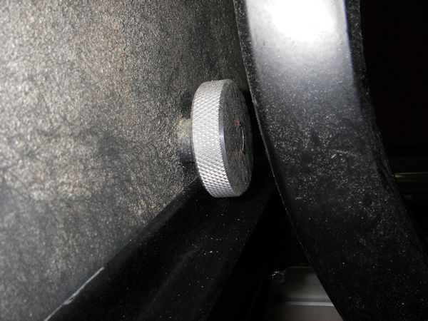

fjimp wrote:My dual tilt came with new instructions for dealing with the lift assist. While installing the dual tilt I moved the brackets away from the ends of tubes. Then moved them back and tightened. All works well. One note my son objected to the brackets potentially interfering with the new lock nut. I pointed out to him that the new locking nut would span the bracket and still lock in place without hitting. Try it it works. Jim
A pix would be 'illustrative'!;)
'Span' mean the threads are longer than the bracket when the knob is tightened?
[quote="JPG40504"]A pix would be 'illustrative'!]
Okay you wanted a picture. I am assuming you desire seeing the position of the lock nut as it relates to the framework of the lift assist. This picture shows that. Please note that the nut is extended over the frame and that the lift assist frame fits against the double lift base. Jim
- DblTiltLockNut.jpg (62.98 KiB) Viewed 3371 times

Thank You! Now I unnerstan!fjimp wrote:Okay you wanted a picture. I am assuming you desire seeing the position of the lock nut as it relates to the framework of the lift assist. This picture shows that. Please note that the nut is extended over the frame and that the lift assist frame fits against the double lift base. Jim
Your picture would have been great, what I was trying to do was have the horizontal bar in front of the knob. The Shopsmith new instructions produce exactly what you have in the picture.
I have a very small gap on one side and none on the other. I may try to adjust it tomorrow to make the gap go away, right now it works perfectly though.
Paul Cohen
Beaverton, OR
Beaverton, OR
This is good news. It is good to hear that you are back to "sawdust mode".paulmcohen wrote:Your picture would have been great, what I was trying to do was have the horizontal bar in front of the knob. The Shopsmith new instructions produce exactly what you have in the picture.
Paul, I have a similar gap on one of mine. After many attempts to minimize it I gave up and simply use it. I am pleased the picture helps. Jimpaulmcohen wrote:Your picture would have been great, what I was trying to do was have the horizontal bar in front of the knob. The Shopsmith new instructions produce exactly what you have in the picture.
F. Jim Parks
Lakewood, Colorado:)
fjimp wrote:Paul, I have a similar gap on one of mine. After many attempts to minimize it I gave up and simply use it. I am pleased the picture helps. Jim
Are y'all referring to a gap between the lift mounting bar(in 'the' pix) and the casting? If the spt mount is perpendicular to the way tubes, I would 'ignore' it.
IIUIC the bar merely prevents the tube clamp(s) from rotating on the tube(s).

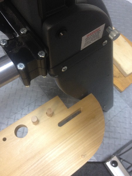

Another hint to the caster mystery
The picture is of my accessory shelf that no longer fits after the double-tilt upgrade (it is screwed in on the left side). It looks like the legs are further appart then they were before, this also allows more clearance for the casters so no need for the washers.
[ATTACH]18043[/ATTACH]
Now I just need to decide if I want to redrill the shelf or the legs.
- IMG_0319.JPG (63.27 KiB) Viewed 3389 times

paulmcohen wrote:The picture is of my accessory shelf that no longer fits after the double-tilt upgrade (it is screwed in on the left side). It looks like the legs are further appart then they were before, this also allows more clearance for the casters so no need for the washers.
Question is, the distance the tubes are inserted into the castings.
I do not understand how increasing the leg c-c distance affects the caster height.
How far do the 'holes' miss?
I would look for assembly alterations before drilling any new holes.
Ed - Have you encountered this? Never mind - ya gots them red things under the bench tubes!
