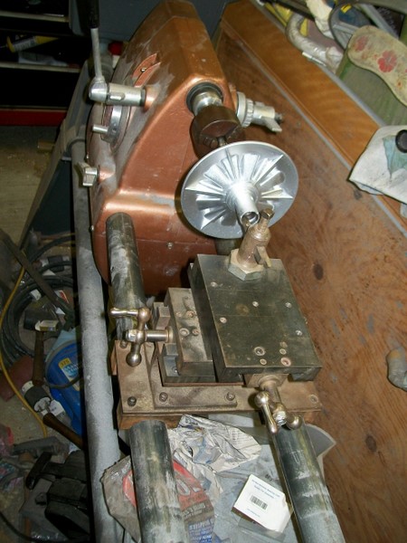

I looked through the web site and found something really cool one of the other members had mentioned to me: the Teknatool Ornamental Turner which shows sold out status. :( http://www.teknatool.com/products/Speci ... mental.htm
What a cool tool, but I do not believe it was ever adapted for the Shopsmith. The only thing close to it I've ever seen is a pic Bill Mayo posted of his Brownie he modified as a machine lathe. I would love to have something like that sits on the way tubes and permits simple machining operations. But first I want to start turning some wood.
