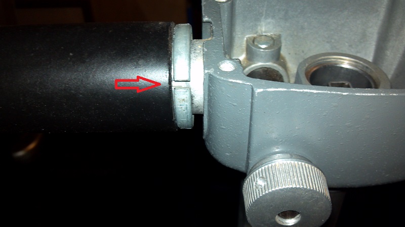

I seem to be having trouble aligning the head housing (air pump housing), so that the upper chuck and square tube line up with the lower chuck.
I have discovered that the eccentric wedge will adjust the alignment of the upper chuck to the lower chuck. By turning the eccentric wedge within the jigsaw tube arm before tightening, the head housing will adjust about a 1/2" right to left when facing the normal cutting position. With the notch straight up, the chuck is at it's furthest distance to the right. Turning it towards the bottom, moves it left.
The notch on this eccentric wedge's collar looks designed for a spanner wrench in order to turn it when adjustment is required to line the chucks up, say during a complete re-assembly like I've done.

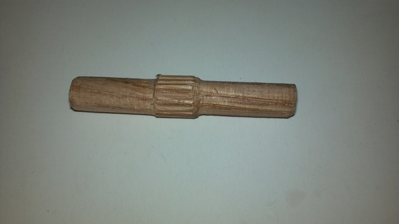

I made a crude alignment pin on the shopsmith to help initially setting the chucks. Only problem with it is the upper chuck has to be removed and the lower chuck's jaws need to be removed. Then the pin fits into the square tube and the lower chuck.
