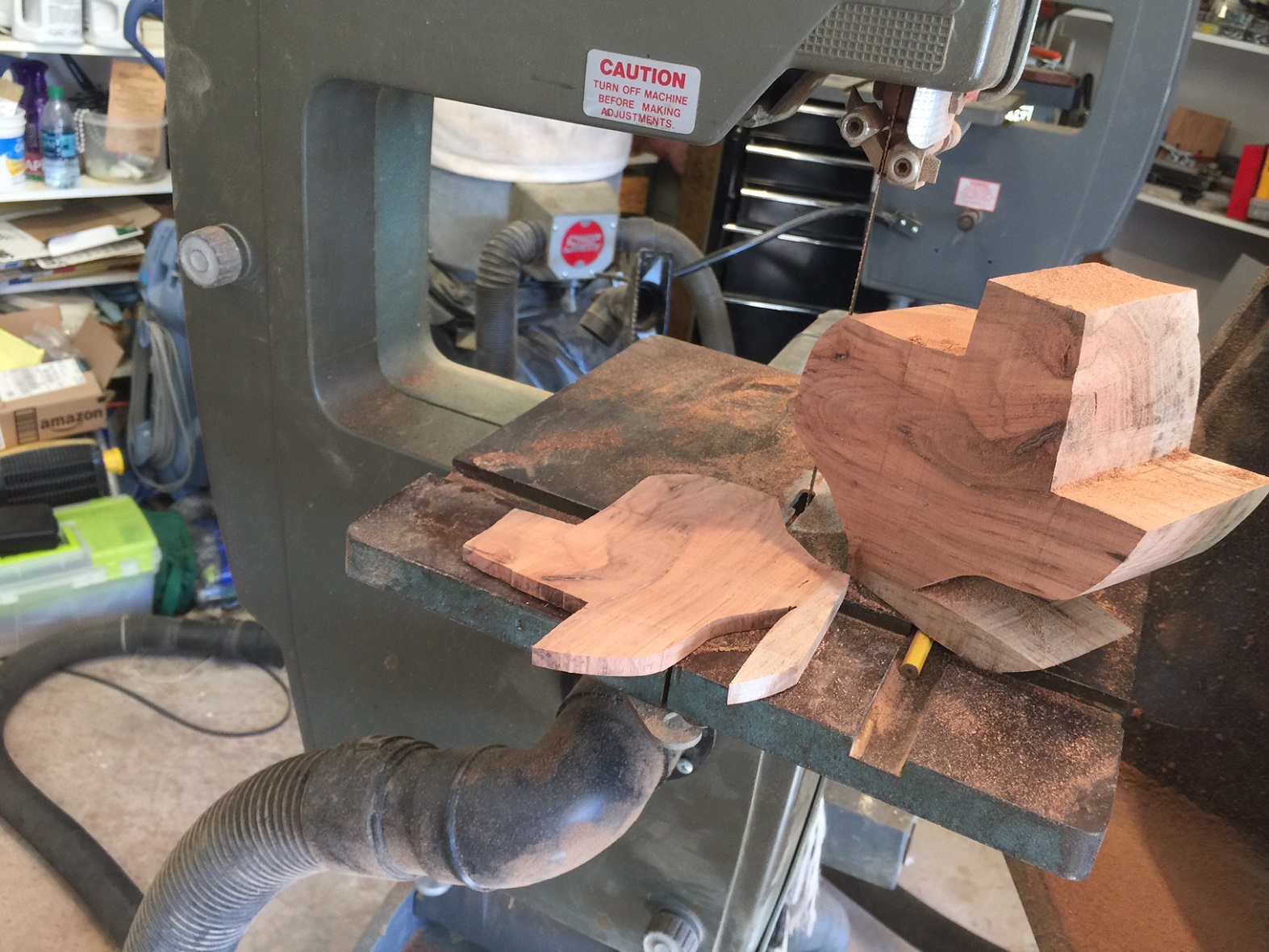

Now that I'm retired as of today, I'm back to making jewelry boxes. I decided to try out a Texas shaped box to start out with, since I'm from Texas.

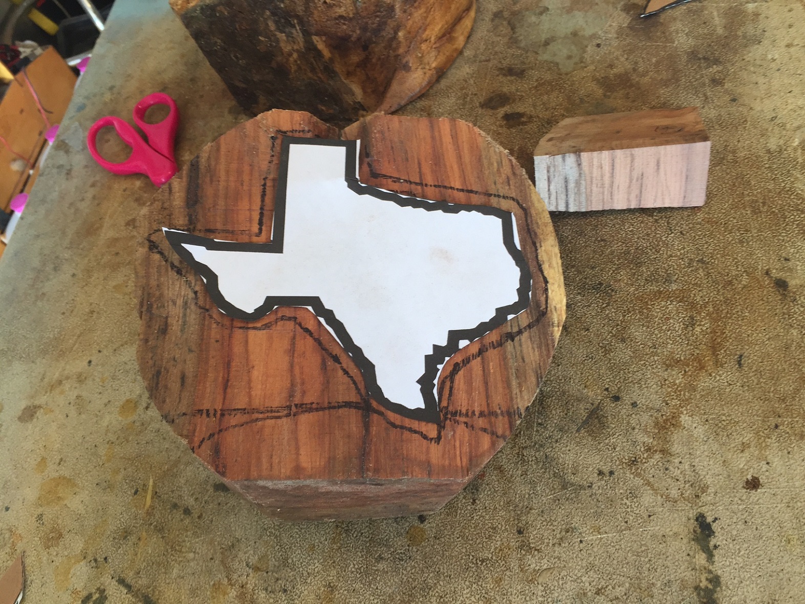

Outline the shape on your wood blank

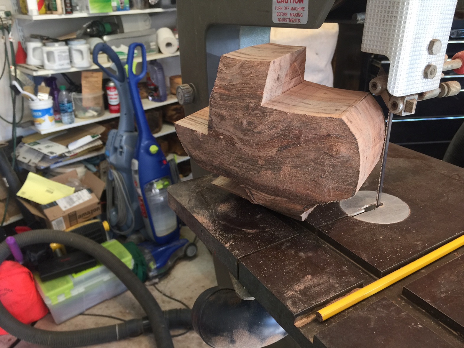

Cut out your shape on band saw

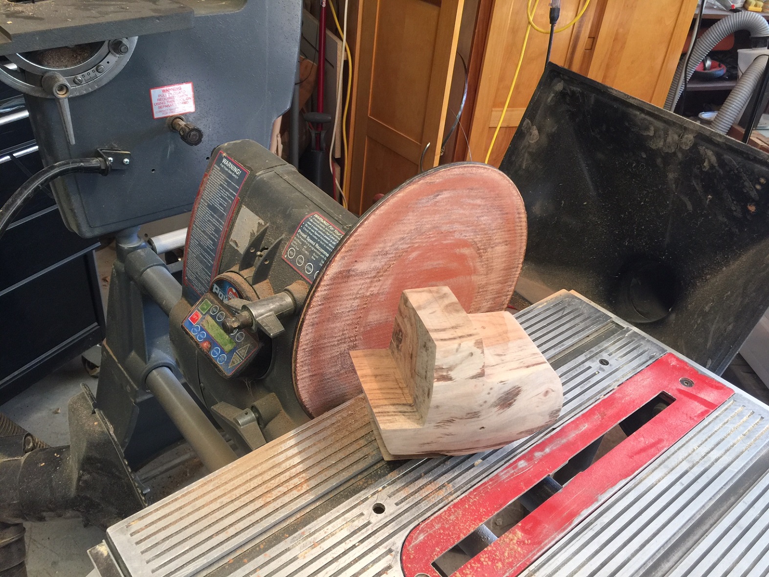

Sand all sides using disk sander
Cut off a slice from the back side of the block.

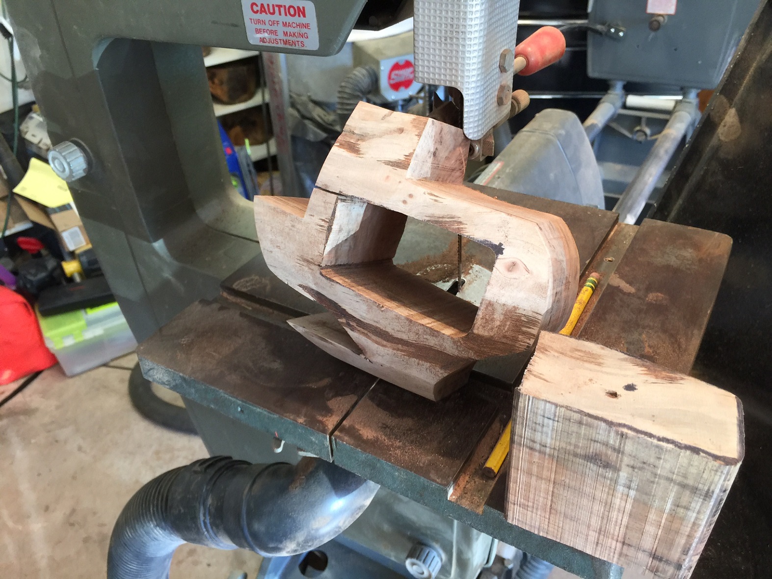

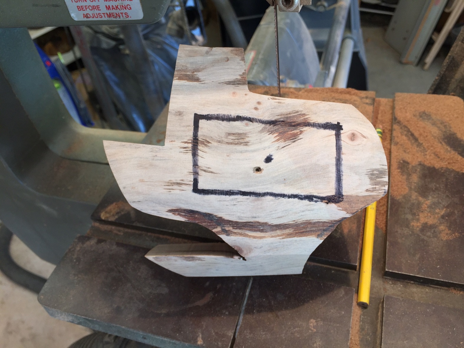

Draw the drawer outline
Cut out the drawer. Notice entry point in west Texas :)
Drawer is cut out of block.
You can see thru the block. You will now glue the back slice back onto the block to form the back of the drawer slot.
Now glue the entry slot you created to cut out the drawer.

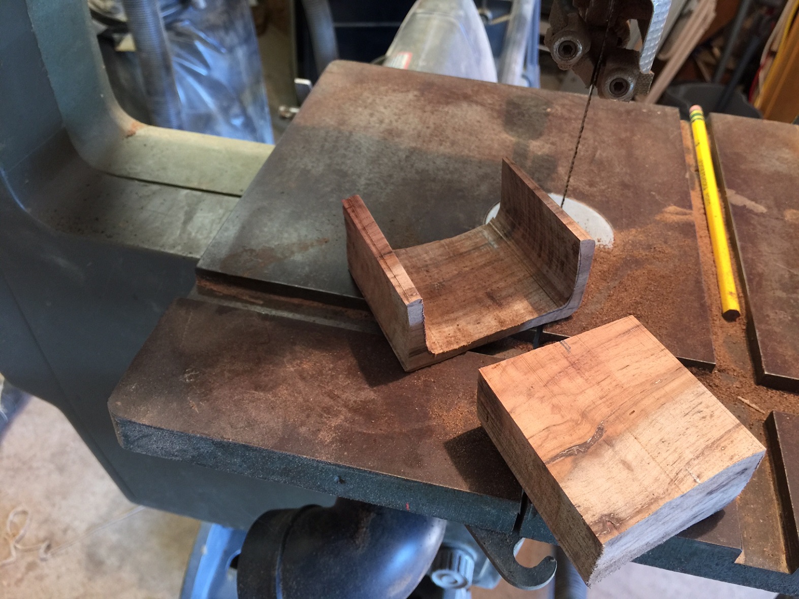

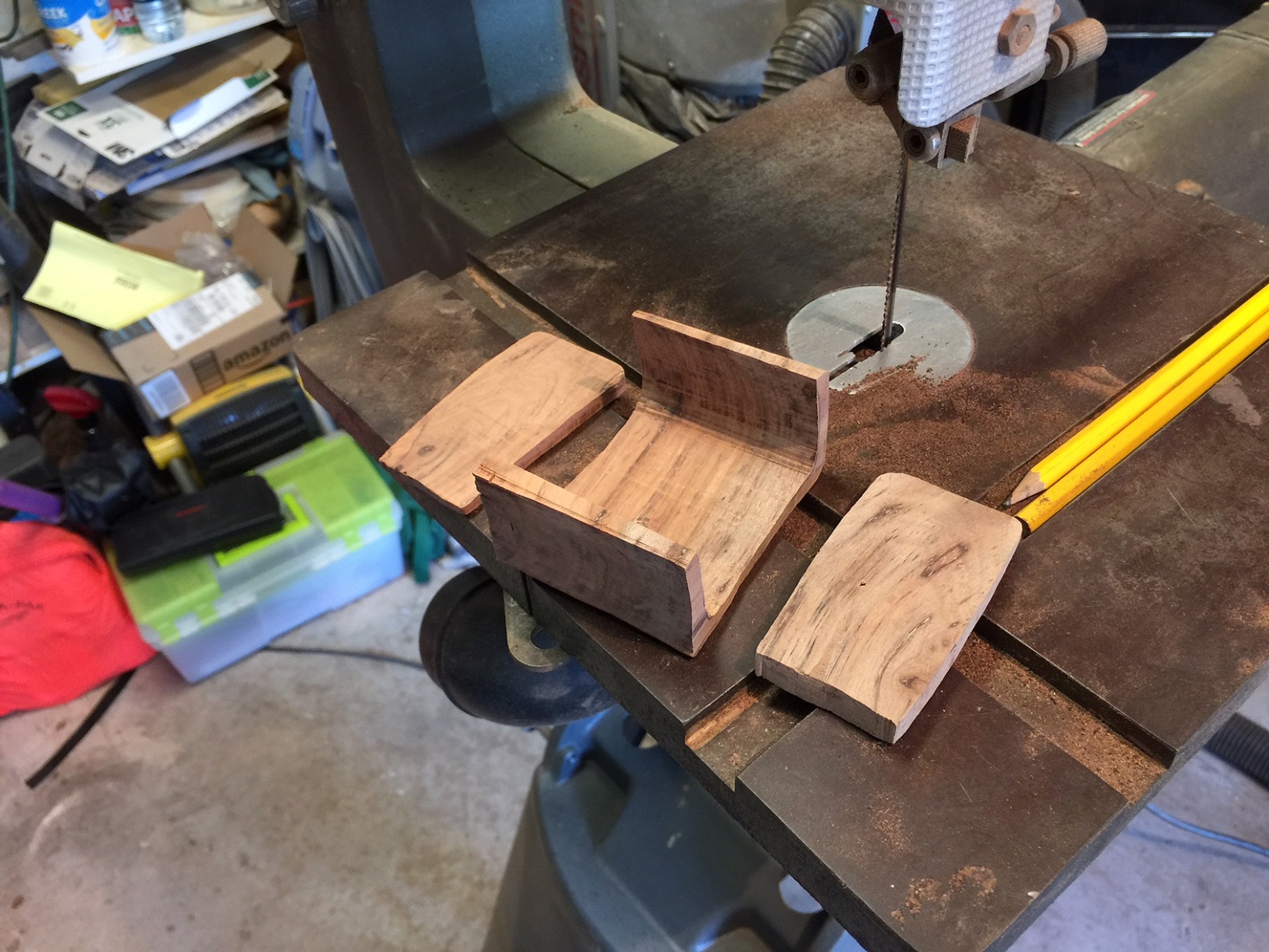

now you cut the front and back slices off the drawer block, then cut out the drawer block.

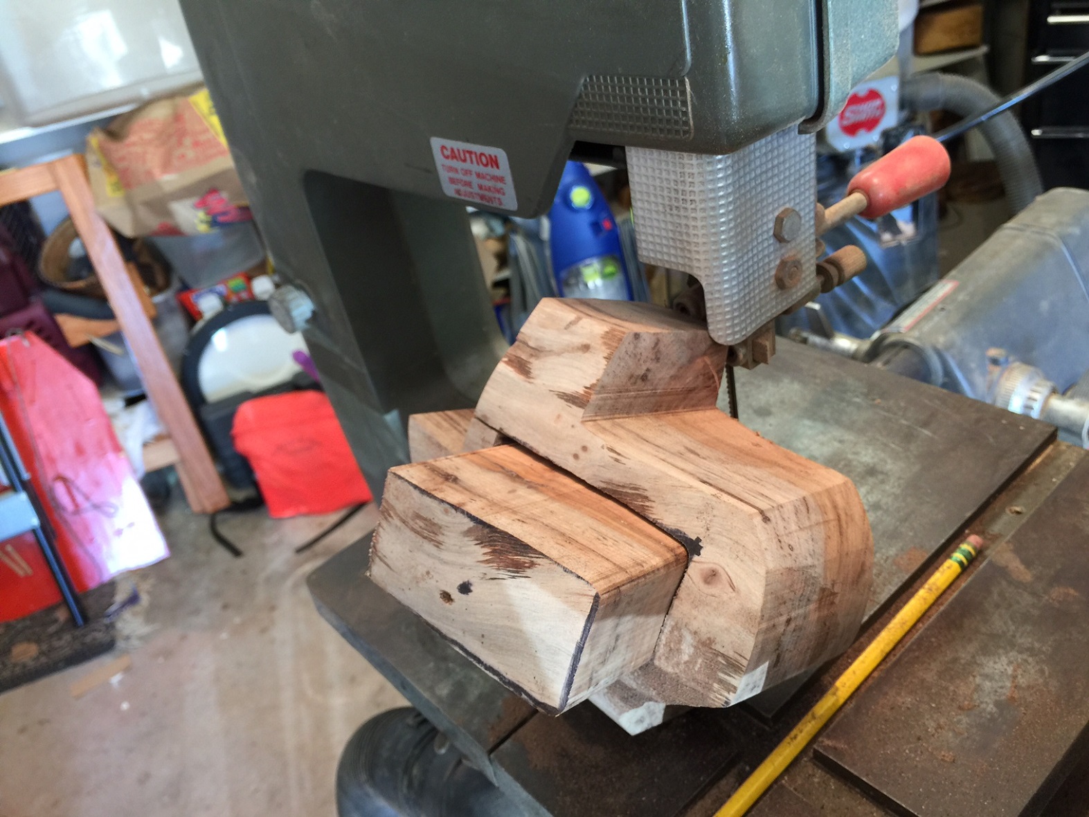

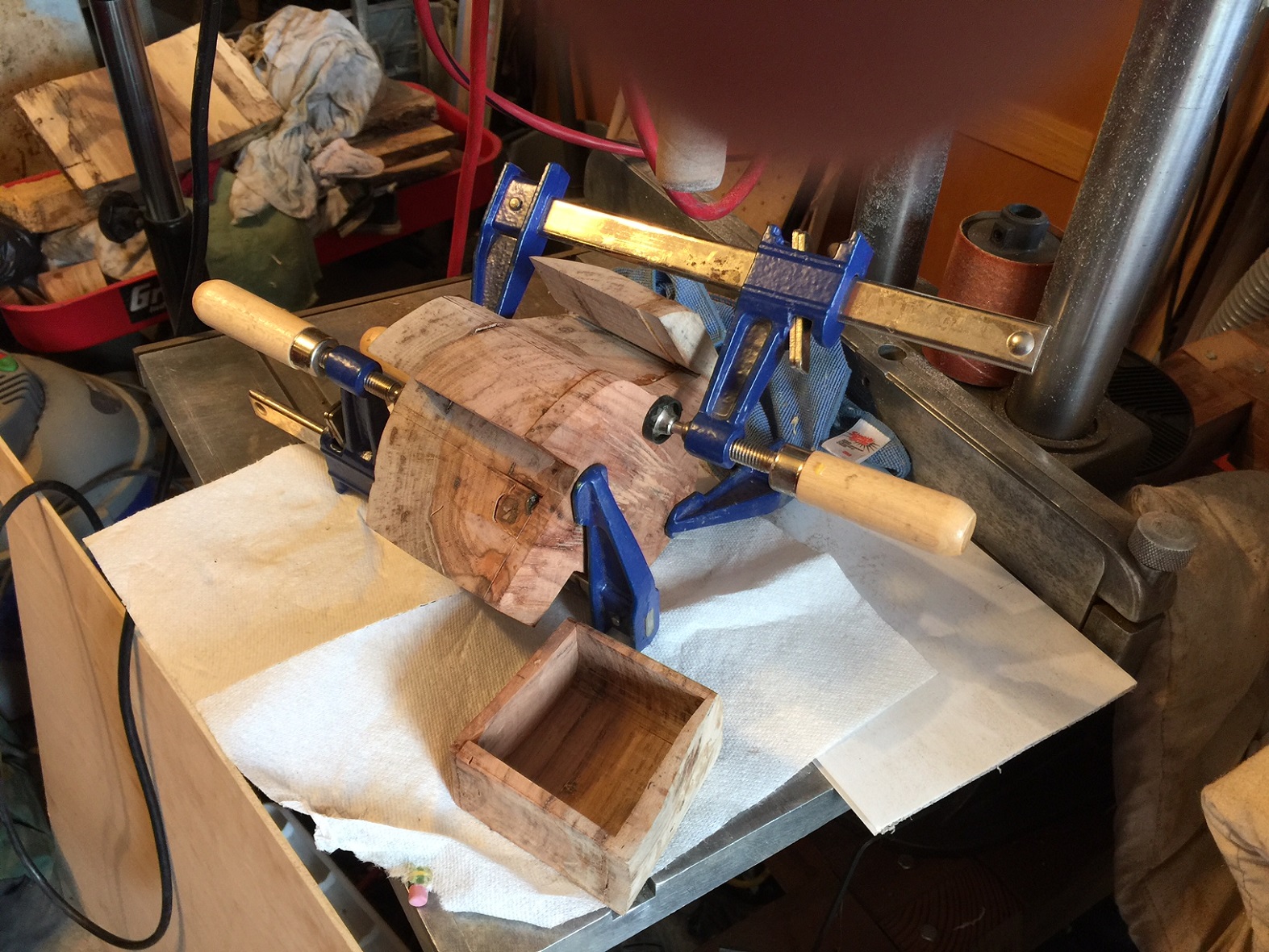

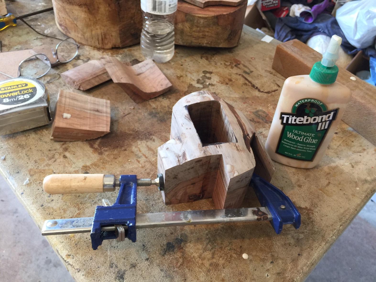

Second batch of photos.

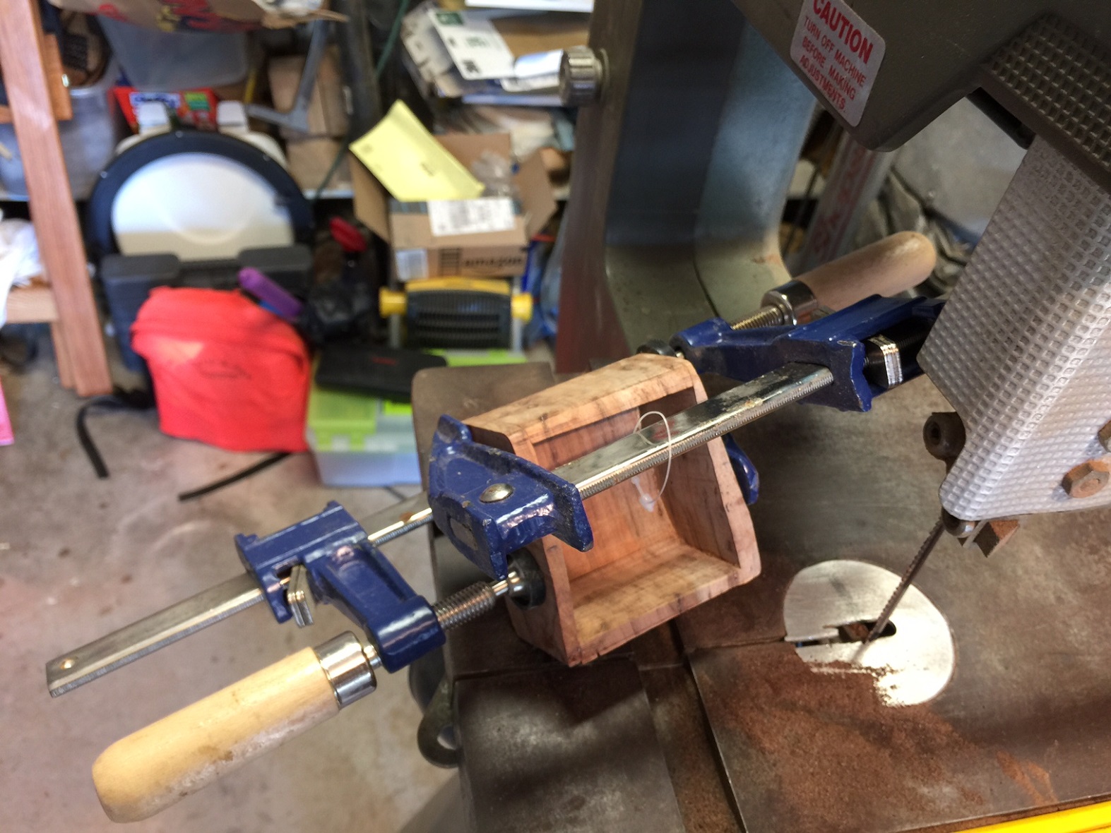

Now you will glue the front and back slices back onto the drawer.
Glue and clamp the drawer front and back.
Glue back slice from original block.

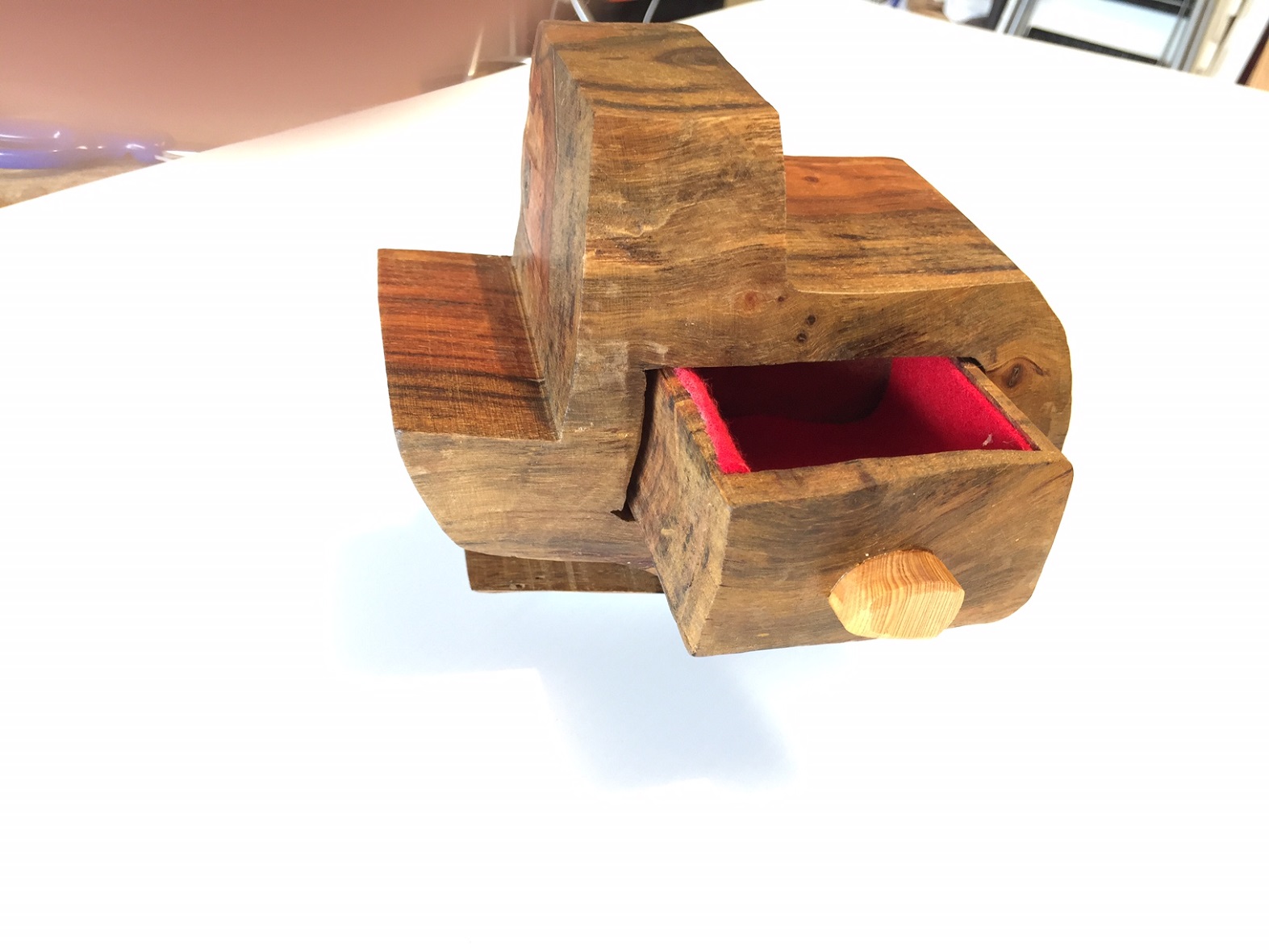

Finished box with red felt liner in drawer.

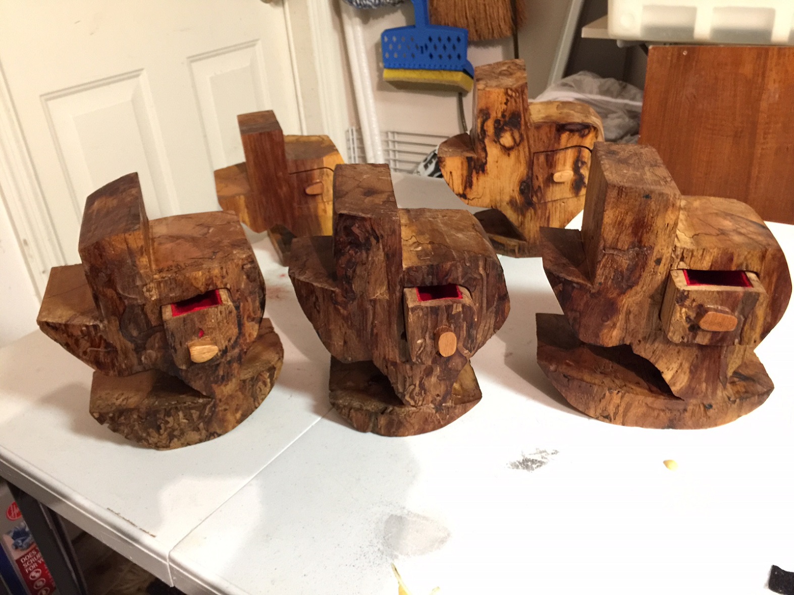

I finished 5 Texas shaped boxes. I like the rounded front better than the flat fronts.
Finished 5 Texas Boxes. I like the rounded fronts better than the flat fronts.
Posts: 35457
Re: My First Attempt at Band Saw Jewelry Box Making
Nice 'finish'! :D :cool:
Posts: 3802
+1 on the rounded fronts. More "character" that way. What kind of wood?

Oak from an old oak tree that was cut down 2 years ago at the Huntsville Walls prison unit.
