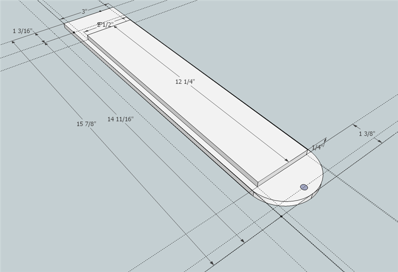

wa2crk wrote:I used some 1/4" plywood that I had leftover from a project. You may want to consider making one for each of the blades you have. They can vary slightly. One size generally does not fit all.Mark the underside of the insert with the blade that it should be used with.

I make mine using 1/2" MDF or 1/2" baltic birch plywood.
When making a table insert, I consider it important that it comes out even with the table surface. I strive to make them very, very close.
The cut out is approximately 1/4" deep but not exactly and this may change "slightly" from table to table.
[ATTACH]24153[/ATTACH]
