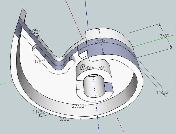

I know I'm way late to the party but does anyone know where I can find the all elusive cam. I need one for my machine and have read through the threads but cant seem to find if anyone still has any available
Posts: 4534
Re: Mark VII
Because the Mark VII was made in the 1960's by Magna American, the company making the Shopsmith tools at the time and not the current makers of the Shopsmith Mark V and new Mark 7, parts are hard to find. Shopsmith Inc. long ago sold out of the Mark VII replacement parts they recieved when they purchased the Shopsmith line in 1972. Adding to that problem is the differences in the Mark 5/V speed control components and those of the Mark VII. There have been some people with 3D printers making replacement cams for the Mark VII speed control and selling them on eBay from time to time. I have even seen one made out of cast metal for sale a few years ago. The seller didn't want one that could melt again and made extras to sell. Very, very rarely does a used OEM cam come up for sale since it is the most common part needing replacement on the Mark VII.
rjent
Posts: 2121
Re: Mark VII
Post by rjent »
The cams are no longer available from anyone as russ pointed out. Occasionally one will become available on ebay, but it is rare. You can get drawing and tech info here for having a machine shop make one for you. It won't be cheap as a one off, but at least it would get you going. I will find the links....
OK, from Everett's Google drive find this machinists drawing. Let us know if you are successful!
https://drive.google.com/drive/folders/ ... sp=sharing
Better yet:
Mark VII Cam 3D View.jpg (34.8 KiB) Viewed 14353 times
